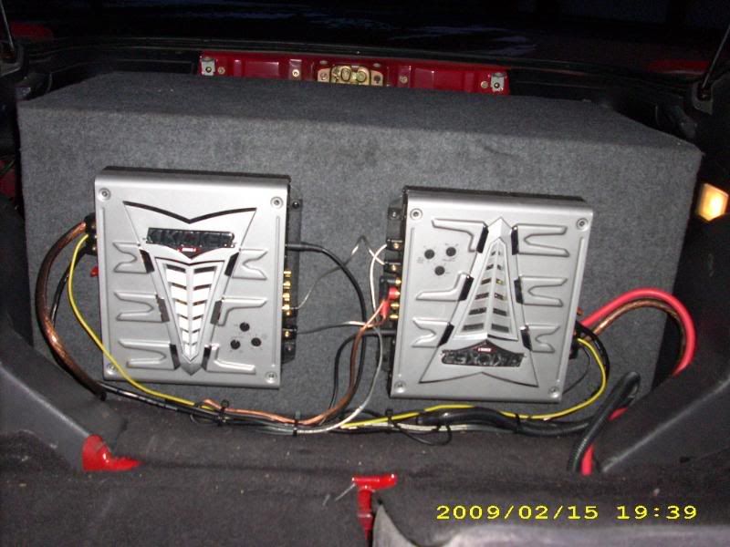

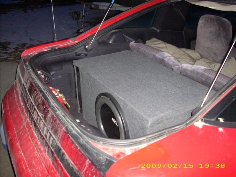

    I cant seem to find any pics at all of my 12 setup in the grand prix, here it is before the rebuild in my old 1g DSM.
    This was my amp mounting, Ive never been very good at that ****.

    nice, that looks pretty clean like that... I was thinking about building something similar but then I would have to keep the current "small" box I think its 18"hx18"wx17"d. doesn't do this sub very well. only hit 136.7 db and that was on a burp at 46 hz... needs new box

    I had a big single 12 setup for a few years, not sure how it relates to your SWX but it was a RE SX motor with upgraded soft parts and woven leads on 1k rms. I had it in a 2.5cu box ported to 30. The port was 3" wide and wrapped around 38.5" long. I ran it facing back and it was pretty ridiculous for a single 12". I mounted both amps on the back of the box though, so with the 28lb sub, 2 amps and the box itself the setup was around 150lbs. I couldnt unload it myself for trips to the track so i traded it for some paint work and downgraded to my current setup. As far as amp mounting I ran out of ideas there. I ended up just paying to have a nice clean panel done.
