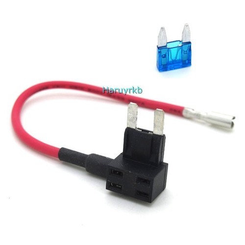

    I run this.

    Quote Originally Posted by E IN v Y View Post
    I run this.
    LOL...just reread the OP. Don't splice into the lines, just add to the existing circuit.
  5. #5 Re: LED light strips under dash and under front seats facing the back
    Jun 2011
    2,103
    That wont splice into anything.
    Am i missing something?
