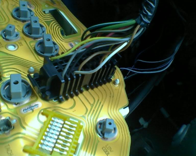

    Just set it to voltage sense and you wont have to worry about the tach wire. The tach wire is supposed to be safer, it is designed to shut your car off if it sees the tach rise too high. This is so if your car decides to floor itself, it will shut down to save the motor. In the 16 years that I've owned cars (and I've owned some hoopties) they have never went WOT by themselves. So I set mine to voltage sense. It's a setting in your menu and should tell you how to set it that way in the manual. If you want to go with the tach wire, it is here on the back of the gauge cluster. White wire, bottom row on the connector, 3rd spot from the left.
