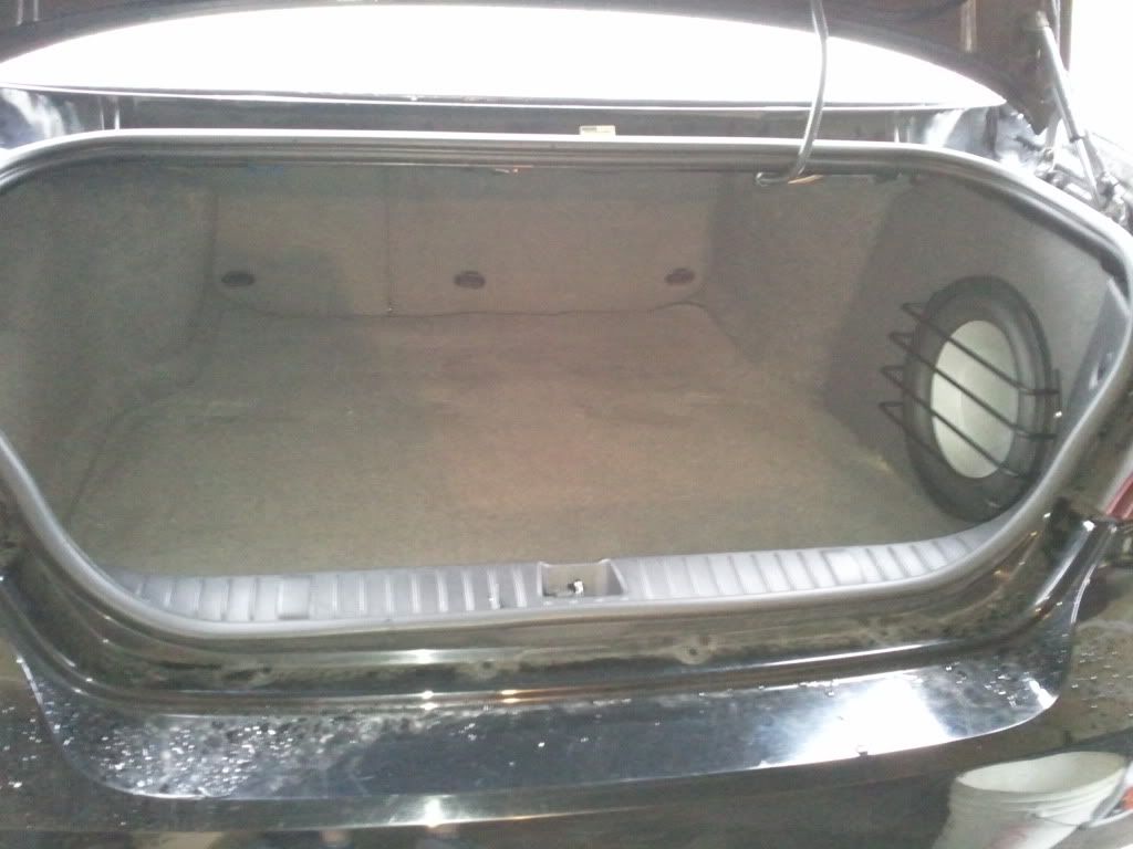

    Are you replacing just the speakers to run off the monsoon amp? Or are you gonna run an amp for said speakers? If you're gonna run an aftermarket amp to power those speakers, you'll want to run you're own speaker lines. The reason being, your current speaker leads run from the HU to the amp then to the speakers. You wont be able to use the leads after the amp (the ones that actually connect to your current speakers) You could clip the lines pre-amplifier and use those, but you'll have to do some internet searching to find out which wires go to which speaker. As for the sub, check with 1800 (he's the moderator for this section) His enclosure uses very little space in the trunk. Mine use quite a bit more space.

    Well, what's your budget looking like? That will be the primary deciding factor on what we recommend. Also, there are MANY options available for running a sub that will take up almost no room. A sealed 8" sub on 300 or so watts will actually fill in a lot, and require an incredibly small enclosure.

    Its just a wall that servers a few purposes: It hides the subs, an amp rack and it blocks a lot of the vibrations from reaching the trunk lid...so it doesnt rattle.
