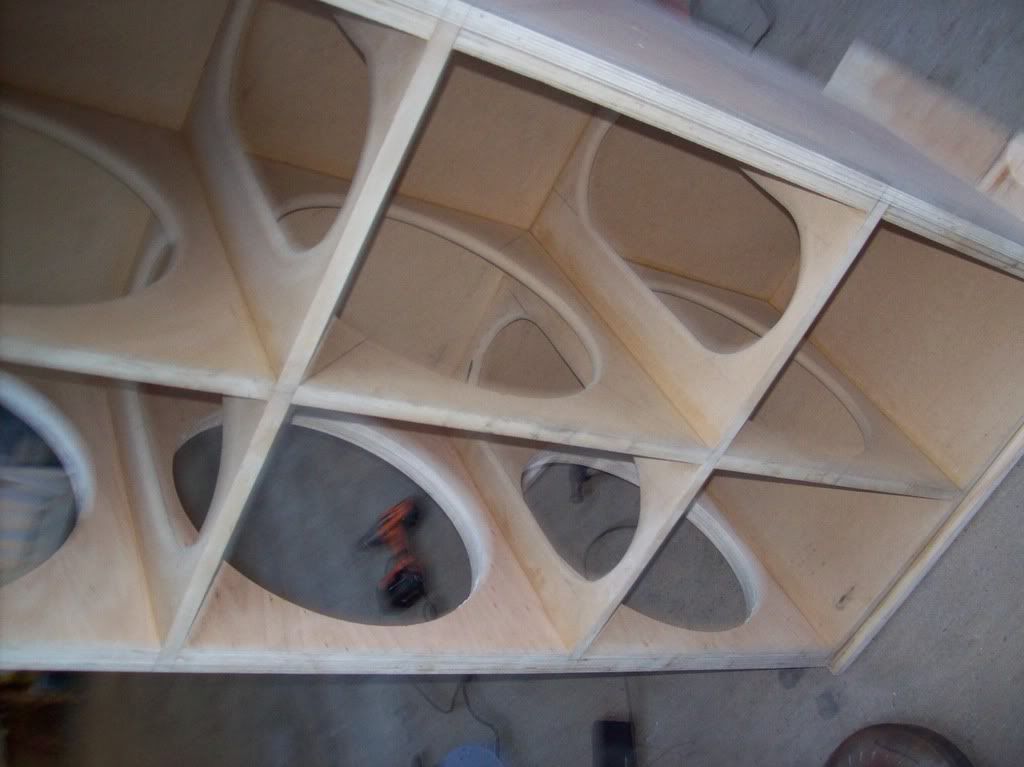

    You want the most rigid box possible.
    Just happens that building it out of MDF and re-enforcing it with MDF bracing makes it strong.
    Heres an example of what I call well re-enforced:
    That sub is a beast... LMS 5400 18... Only multiples.

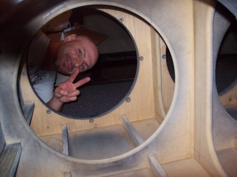

  11. #11 Re: Fiberglass VS. Wooden Sub Boxes
    No that really isnt me.
    That guy IS insane though:
    [IMG][/IMG]
    Heres another picture without that guy in it lol:
