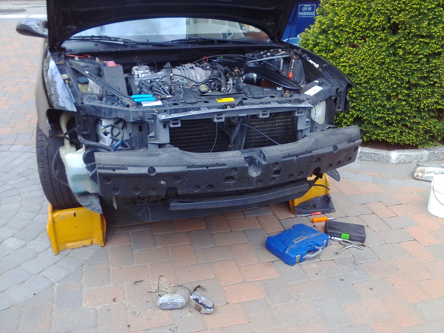

    Horn was working fine till out of nowhere the alarm sound/chirp started to get weaker and weaker and b4 i knew it the horn complety stopped working. I can still here the alarm when unlocking and locking the car doors but very fainted and barely.
    00' GS, and ideas?

    pull the bumper off. check the grounds
    or install WRX horns behind the grills

    When you say the alarm.. do you have an aftermarket or do you mean the single/double beep of the horn?
    If so.. the horns have likely gotten too much dirt in there and you need to replace them.
  4. #4 Re: alarm and horn
    pass side under the head light is the horn, see it sticking out just past the bumper foam. no need to take the bumper off to get to it. i had it off to paint it.

    Its an After market alarm, AutoPage. Auto start still works, doors lock and unlock. The chirp is just very low. Its a coincidence that the horn goes out at the same time as the aalarm chirp sound goes very low
