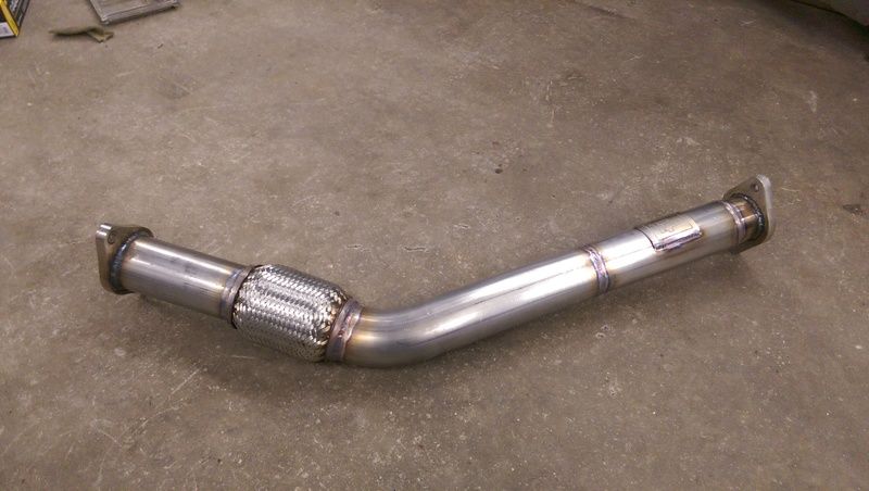

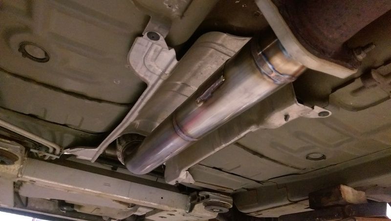

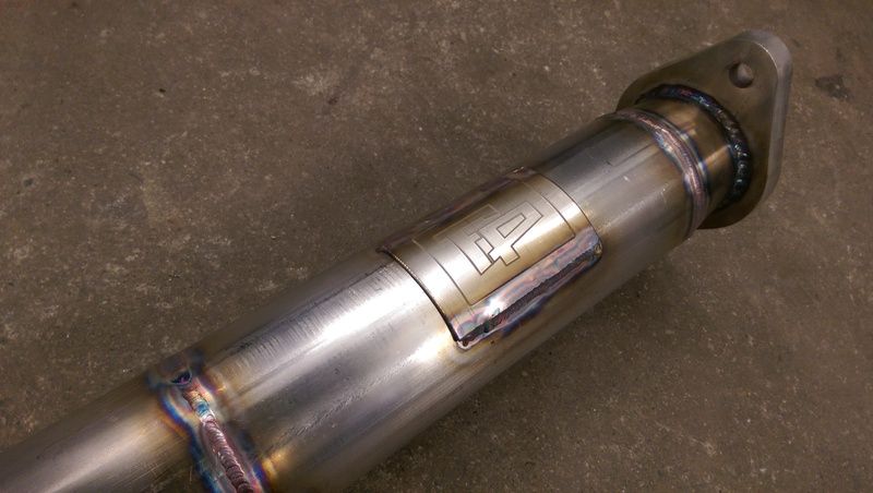

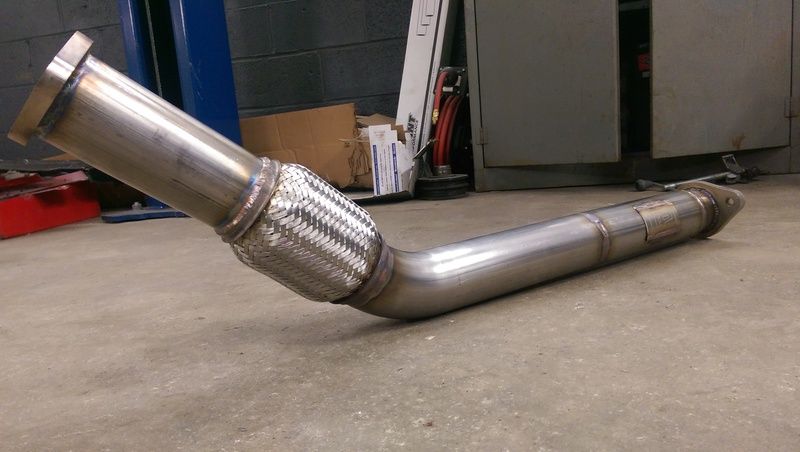

3" catless downpipe prototype is all buttoned up and on the car. Here are a few photos of it going together last night. All thats left is to tack on the hanger when they come off the CNC.
Complete 304 stainless construction, 1/2" 304 flanges, concentric reducer, interlock and lined flex....best part is it bolts up with no modification!

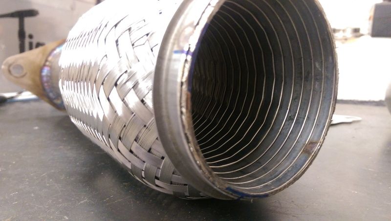

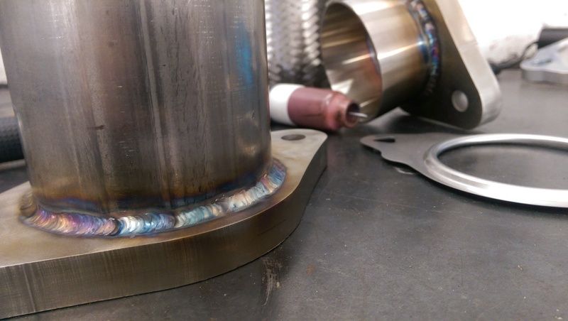

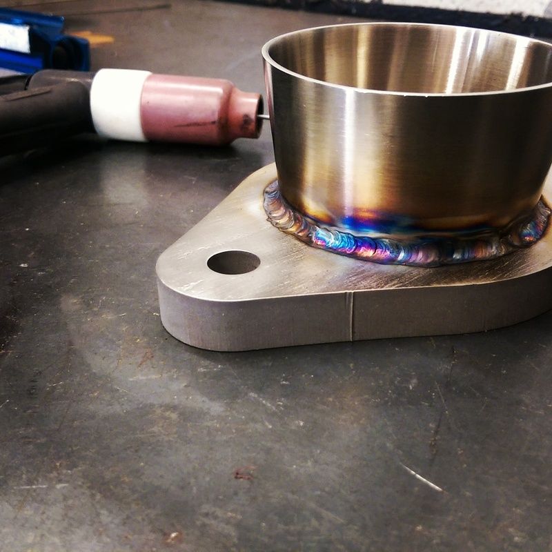

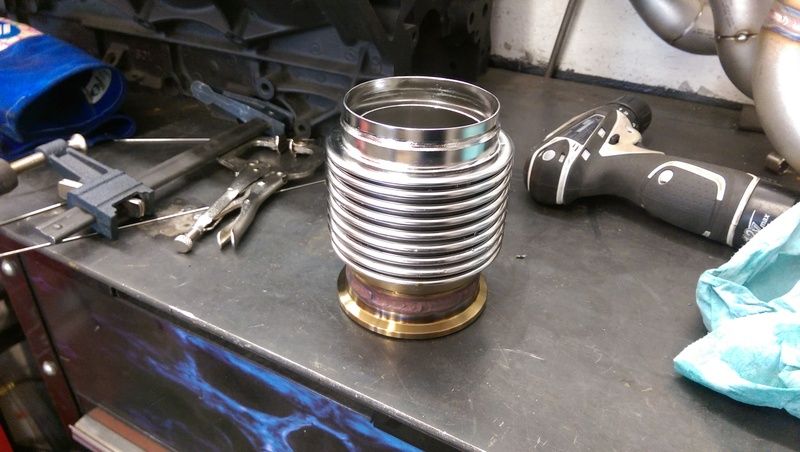

Overall I am very happy with the results. Only things I am going to change on the production pieces are the flanges and the flex. The flanges will still be 304, but I am going to step down to a 3/8 thick piece. For the flex, I am going to use smooth walled bellows like these ones we use on our tubo cars...
