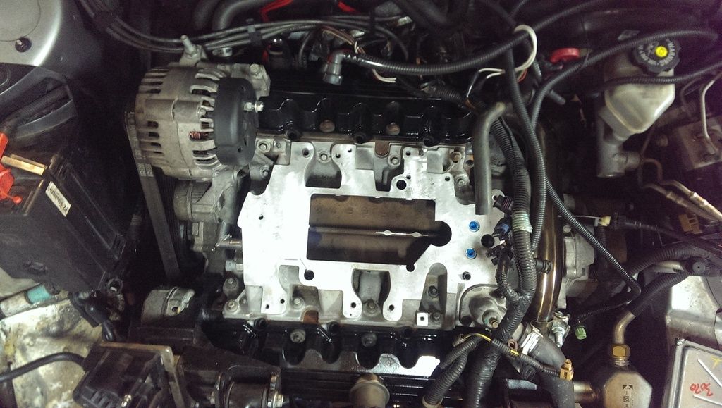

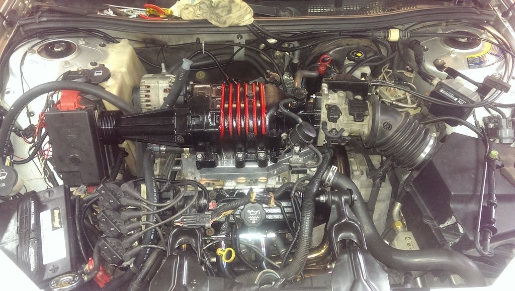

Can you post a pic of how the setup is as installed (minus installing it of course). I am not sure how the system is piped, I have seen other pics and it looks as though the the inlet and outlet are outside the manifold adapter. I have run into situations where a device leaks under one condition but not the other, so it acts kinda like a check valve, that's why I was suggesting using plexiglass on top and bottom. At this point I have only seen LIM from the top with the SC off and I'm not familiar with the actual adapter/spacer that goes between the SC and LIM. I am assuming you tapped and plugged the LIM to block of the TB water passages?
i would pull the vacuum and leave it for at least an hour.
