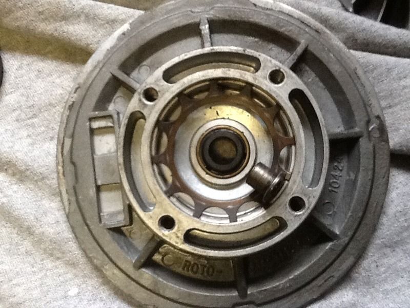

    Finally got around to the rebuild and so far i'm gonna need a replacement turbine shaft as the threaded end snapped off. That and some of the parts in the t3/t4 rebuild kit are different. Not sire if its worth the cost of rebuilding the unknown vs the cost of an ebay turbo.
    The thrust collar is alot different as well as on my compressor backing plate
    http://i152.photobucket.com/albums/s...age.jpg1_3.jpg
    And on the backing plate theres a seal and a brass bushing with this sleave in it that is where i am getting play. Those pieces are not in the kit
    http://i152.photobucket.com/albums/s...age.jpg1_2.jpg

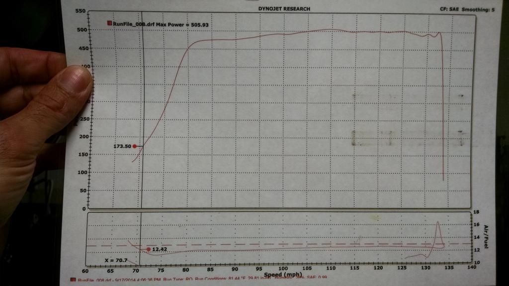

    Also just a side note, gennerally twin charging (SC and Turbo) is a cool thing but not a very efficient thing. While the S/C does "Run out of steam" per say, it really comes down to we can't spin it any faster efficiently. This is why people switch to turbos. Now, twincharging is cool don't get me wrong; however, its very inefficient. The blower becomes a restriction for the turbo, it cant spin fast enough to force the air into to motor. You would have a hella fast spool, good mid, no upper. Several guys have tried it and enjoyed it for the cool factor, but for numbers Turbo is where its at. Now its your car. Do it if you want, and take lots of pictures lol
    Dude what are you talking about. No upper?? got to be ****ing kidding
  15. #35 Re: What size is this turbo?
    Aug 2013
    Kitimat, B.C.
    267
    Quote Originally Posted by danomite02 View Post
    What turbo were you running for that dyno?
    86 Fiero se convertible 3800sc 4t65e HD(2002), Gen V, 3.3 pulley, SD headers
  16. #36 Re: What size is this turbo?
    GTP Level Member danomite02's Avatar
    Jul 2011
    CT
    636
    Its a T70. .96ar hotside.
