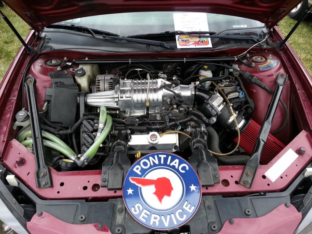

  13. #33 Re: Second valve cover breather
    Can kind of see it here
