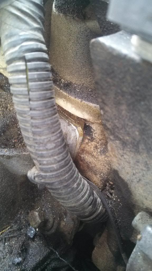

    I think I'm lucky and got the metal ones! sprayed off a little bit of it with engine cleaner and this is what I saw. Looks more silver-ish than the pic shows but definitely not black. Pic is looking at the back right portion of the front valve cover for reference.
    So now Im thinking it's those plastic coolant elbows that are leaking down there. But that's a way easier job than the LIM gasket! You can see some of the grime I'm talking about in the picture right at the base of the LIM.
