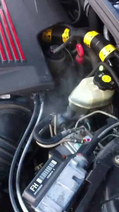

    hey im still new to this scene. car is still new to me.
    So from a cold start there is some kinda line(issue is the "thing" what the line is connected to?) that's by the TB, it first starts off just steaming/vapors/smoking and then it starts to frost around it. I have no clue what the hell this is and don't think it should be this way?
    any help would be greatly appreciated.
    Thanks

    sorry forget the important stuff. shes a 2002 black 4 door GTP. took a couple pics and a video to show u what im talking about
    http://s749.photobucket.com/user/ffotsud/slideshow/

    That would be the egr valve.
    Check for leaks on the exhaust manifold connecting to it.

    seems like its just leaking from where the egr is bolted. that rusty piece is where it comes from

    You have a few options. You could try and find/repair the leak in yours.
    Pick up one from the junk yard
    Or you could take it off the car and block the ports on the intake manifold and the exhaust manifold.
    It's part of the emissions system. You dont really need it. Aside from losing 1-2mpg, It won't affect the engines performance.

    It recycles exhaust back into the intake. Deleting it entirely will keep your intake and oil cleaner.
    If you plan on modding, it may be easier just to delete it.

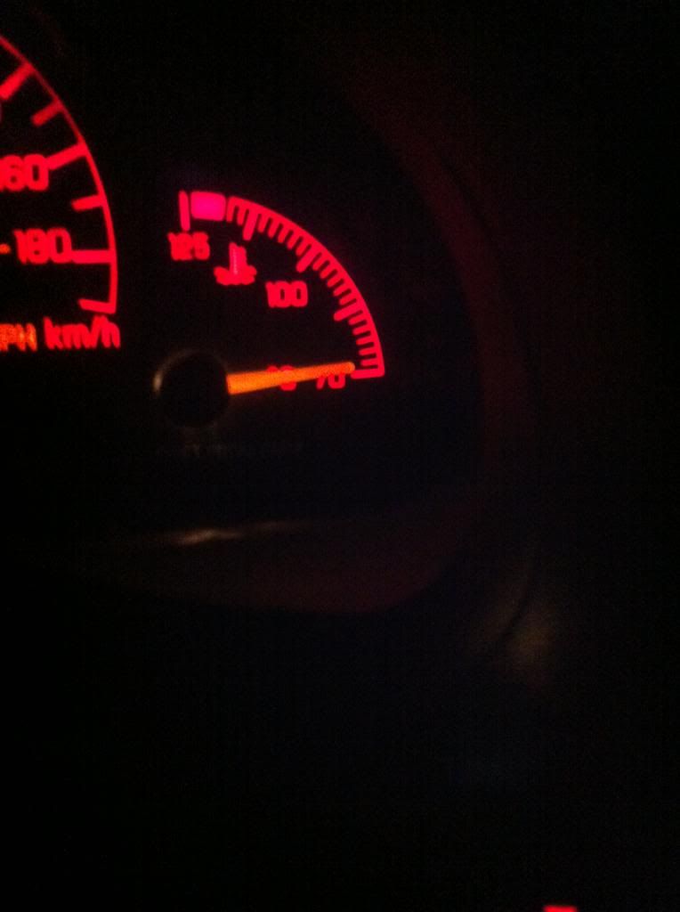

    would this be causing my temp gauge to be very low? or is that still the t-stat?

    this is how low the temp gauge runs on a warmed engine... seems to sometimes jump a LITTLE when idle and warm, only sometimes

    Some thermostats stay open when they go out. That would cause the coolant temp.

    Quote Originally Posted by Dustoff View Post
    Time for a new thermostat.

    Don't remove the cat on 01+ cars, you'll just make it run worse.
    And no, thermostat and performance don't go in the same sentence. Grab a 195ยบ and pop it in there.
