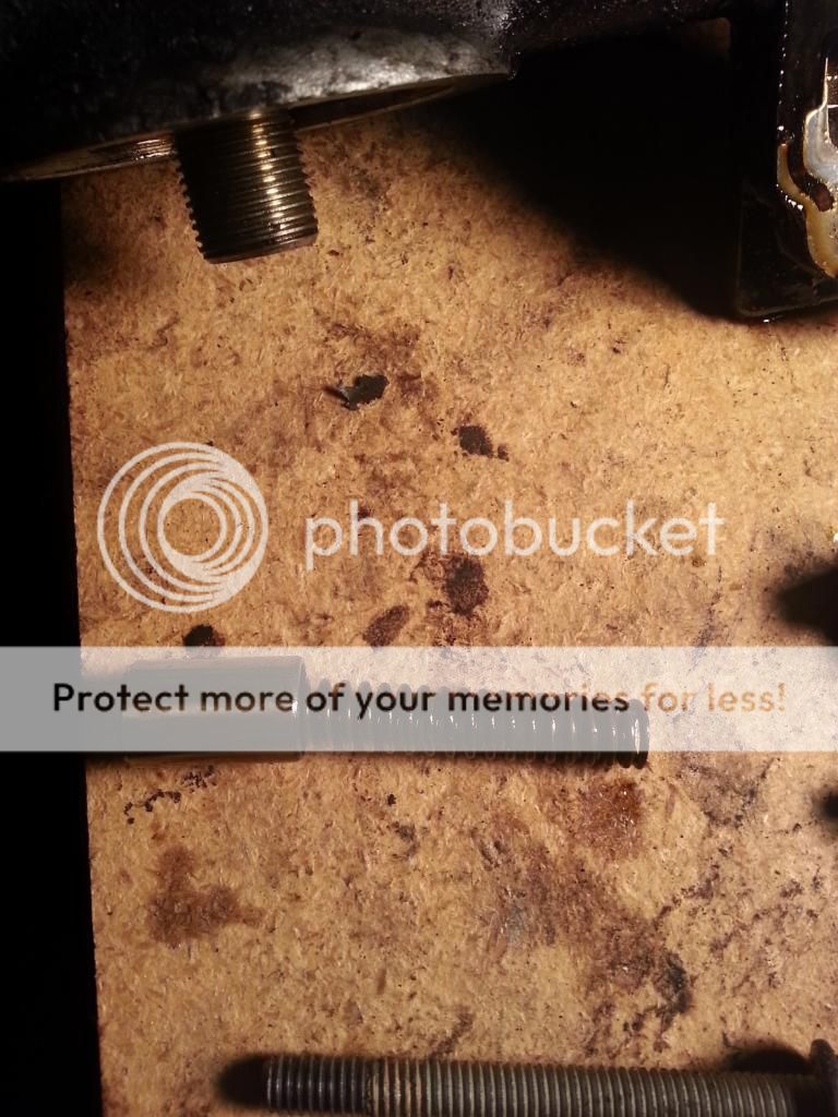

Looks like the filter adapter is coming off. Dammit.
Picture of the valve
http://i912.photobucket.com/albums/a...ps8765ff91.jpg
I don't know what you're particularly looking for in pics to investigate, but I'm sure I have one, lmk.
If the plunger and spring are installed backwards it will cause very litte to almost 0 oil pressure. Consider the motor toast.
Edit....link to pic of how it should be sitting in the housing
http://intense-racing.com/Merchant2/...de=3800_Engine
if the filter was dry, and nothing came out when you took the sensor out, you indeed have 0 oil psi.
that spring and rod just maybe in backwards.
Oh man, you don't really think it would be toast do you? I mean, it was running smoothly, and it has been on maybe a minute cumulatively at idle. The valve was definitely in backwards, I wish I had known that intense had that picture. I suppose I am looking at oil pump damage huh?

Well, I pulled the neck off, the valve looks okay, but I don't have the shim between the spring and the valve that the intense photo shows. Is this piece absolutely essential?
That may be in the psiton... but thats just a guess
No you shouldn't have that little piece..... that's part of the kit that they sell and is not a stock item.
