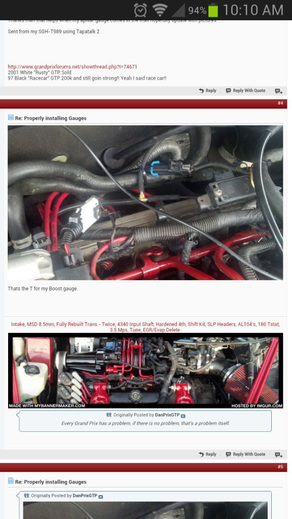

    I did it right where this guy did it.

  19. #19 Re: 2 different vac readings?
    GT Level Member m17davis's Avatar
    Orland Park, IL
    369
    so the guy in the picture above did it wrong too?
    Ported Gen III ~ 3.4 ~ HAI ~ 180stat ~ 605's ~ Speed Daddy's ~ SLP Catback ~ A/C delete ~ Aluminum Sub-frame ~ AGX Coilovers ~ Vinnie Spacers ~ Fusebox & PCM Relocation ~ Wire Tuck
  20. #20 Re: 2 different vac readings?
    Orland Park, IL
    369
    its not in the wrong spot. It is right between the T on the lim and the map sensor. on the back side of the sc. bill even said so in a thread on here.
