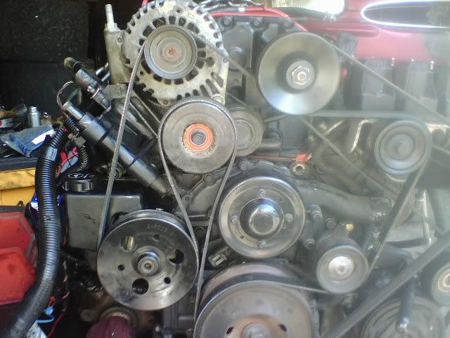

    The crank pulley is about the least likely thing to cause slip, due to the amount of wrap, and being on the ribbed face.
    Are you running an oversized pulley on the tensioner? It seems that if you leave the 3.0" stock one, the belt can run into itself when passing back down past the P/S pump.
    Here's a pic I took trying a 4.0" pulley I found at a yard just to mess with (3.5" is what many Meziere folks run):
    You can see how close it is, even though it's not snugged up. Also remember, it's a full inch bigger than the stock pulley, which brings the P/S side and W/P side closer to each other on a 3.0". Going larger also helps tighten the belt & bring the tensioner pulley down to a better position that moves the belt further away from the P/S pump, too.
    Couple that with the fact that this is the driven side of the crank pulley... meaning the crank is "pushing" the belt outward as it comes up that side, which will bring it closer to the P/S pulley as well.
    - Dave

    so basically Zef is right, the belt is too long and you are suggesting that I get a 3.5" idler as opposed to the stock 3.0 pulley. it still bothers me that this is happening now after I have been running this setup for a while. SO I assume the belt will not touch the water pump with the 3.5" idler. Looks like the 4.0 that is in that pic the belt is touching the WP

    The Meziere head isn't as big as the pulley, I was just mocking this up a few months ago with that big pulley in different arrangements.
    As far as the belt, it being possibly too long is only about 1/4 of the reasoning I used above. If that was my only point, my reply would've been alot shorter.

    Well, It seems after I cleaned the pulleys it still squealed. I swapped the idler pulleys so teh 3.5 was on the accessory belt and started her up. Everything was good again. It seems that there is a bolt right by the crank the the belt was riding on due to the non gm idler assembly. Using the 3.5 idler increased the wrap on the crank enough to avoid the bolt. Either way, all is good now. Thank you guys for the input. I would have never thought of using the 3.5" idler
