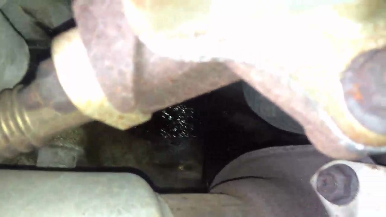

    Will do, now all that "wetness" does that look like the valve cover or did I mess up doing the lim
    I think I messed up

    Is the side of the head wet with oil? Becauise it would be tough to have that much of a leak right there w/o it leaking for a while. I literally biffed on my car doing a lim once. The endseal went into the lifter valley and ... well I'm the kinda guy that said.. I have to pull it apart in a couple weeks anyhow.. I drove it that way say 500+ miles. The end of the block wasn't really even moist with oil. Oil just splashes around in the valley, it's not a pressure situation.

    once the upper paper gasket gets hot theres a 100% chance it will rip or break on you. i think rock auto has the gen 5 gasket for a bout 40$.
    theres no vacuum in the valley, so no oil or hissing should be seen or heard.
    de grease your engine then keep a close eye on it for the oil leak. and try spraying carb cleaner around the lim, the upper gasket under the sc, the vac lines, every thing basically.
    then you can always hook a vac gauge up to the car and see what your vacuum is.
