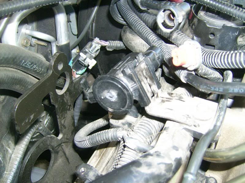

    I had to replace my upper motor mounts and when pryingthe engine forward to line up the holes I broke a vaccum line going to a cylinder on the back of the fuel rail/engine.

    evap thing. I have one I'd sell if you're interested.

    Had the guy at Napa help me figure it out, I am roughly 250 or so miles from home at the in laws and needed to be home by tonight but thanks for the offer.

    Vapor Canister Purge Solenoid orielly has them for 34.99, dsmuts ill give u a dollar for it i broke mine too lol,
