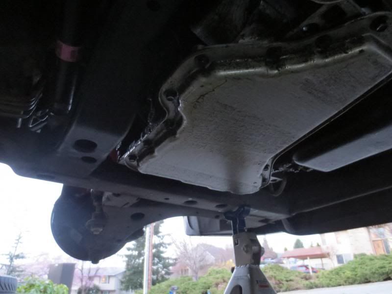

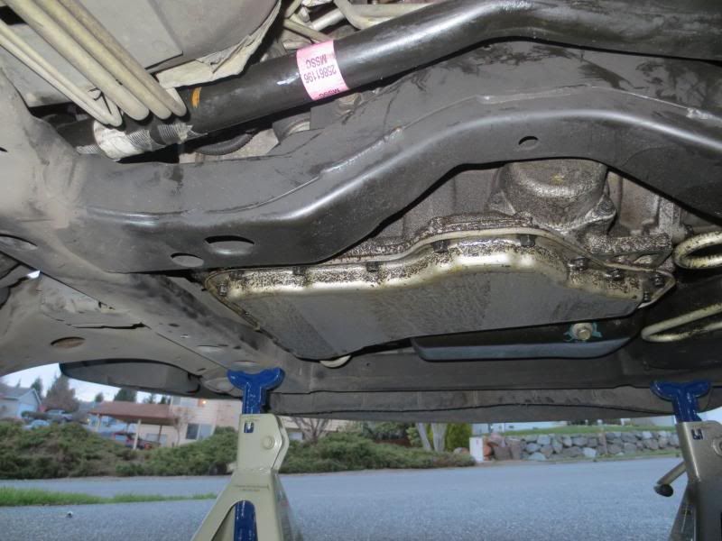

    So I got the car all jacked up and I think the dooods at JiffyLube were off about the leak nothing seems to be leaking after taking a look it might have been that coolant overflow when the car has been running for a while?

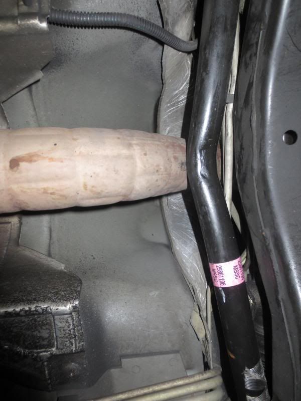

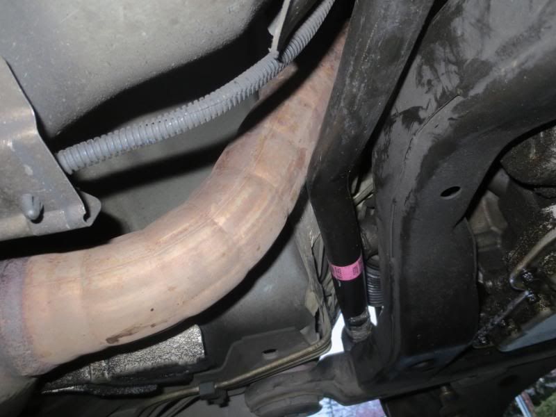

    So I made sure all the new suspension parts were good and torqued and I noticed that my new Front Sway barely hits my Down Pipe, could this be causing the odd smells?
    Another angle
    Does this look like a leaking tranny pan to you guys?

    rear valve cover is leaking when you see oil on the tranny's back side of the pan.
    the sway bar looks like its hitting the DP too. you may want to flip it over.
    re looking at your pics your engine must be as oily as the trans. its greasy looking for sure.

    As far as the sway bar goes what do you mean by flipping it over? I thought that there was only one way they fit due to the bends? Will shorten dog bones pull it off? I also have engine and trans spacers I was going to install those when the new suspension settled in. I was also going to flip my dog bone bushings this weekend as well. Hope one of these helps, installing that sway bar was a Beeyatch!

    in post #4 second pic the black bar pink tag is rubbing against exhaust pipe will eventually cause a hole in the pipe, and vibration.
