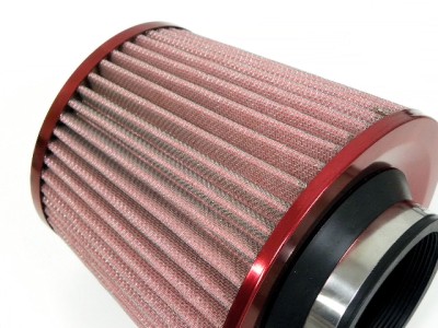

    Firstly! I bought a good quaility cone filters for the gp gt, universal fit but its exposed without a heat shield, i have that part covered, but it doesnt say if its all weather, i dont plan on getting wet but its stupid to think ill never drive in the rain at some point? input? HELP?

    Its all weather, and you dont need a heat shield, but its your choice.
    The stock intake box has holes in it and get can wet too and nothing harms it, and only if your puddle jumpung will water ever splash up and hit the upper parts of the motor.

    You'll be fine with that filter. You're storing it in a garage so that's better than a lot of cars get stored. Last winter I had my car parked outside of work and the wind was hitting the front of the car and snow went up into the engine bay and completely covered the filter. I dug out what i could and let the engine warm up and melt most of the rest. The filter is rusty now but still works fine.
