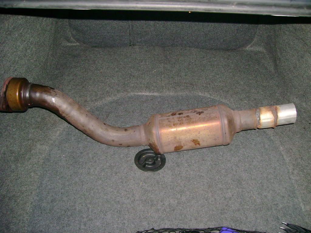

    Stock DP FTL:
    2009 Subaru Impreza WRX STI

    Quote Originally Posted by Sabrewings View Post
    Stock DP FTL:
    Did no-one read my Sig, cause like 2 people said to drop the u-bend and stock DP, my 2.5 off road DP was my first mod like 3 years ago

    Quote Originally Posted by 02BlueGT View Post
    I suppose not.
    Stock DP FTL:
    yup... i took that thing n sold it to a scrap yard for 75 bucks!

    Quote Originally Posted by justwhisen View Post
    no frickin way. that trunk looks way to clean.
    Car was 4.5 years old in that picture. Now 5 years old.
