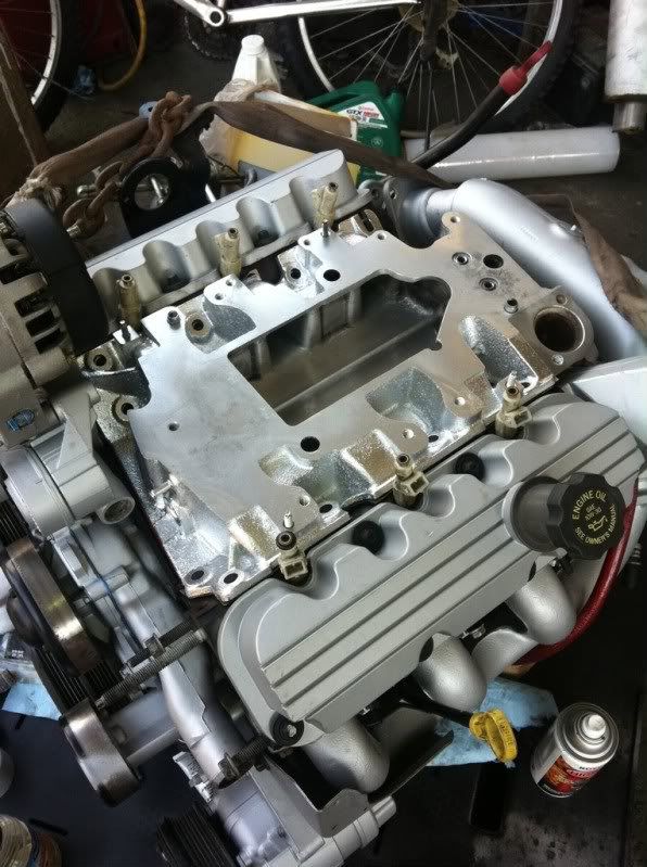

    This is the engine i have on my other gtp with the ported lim.
