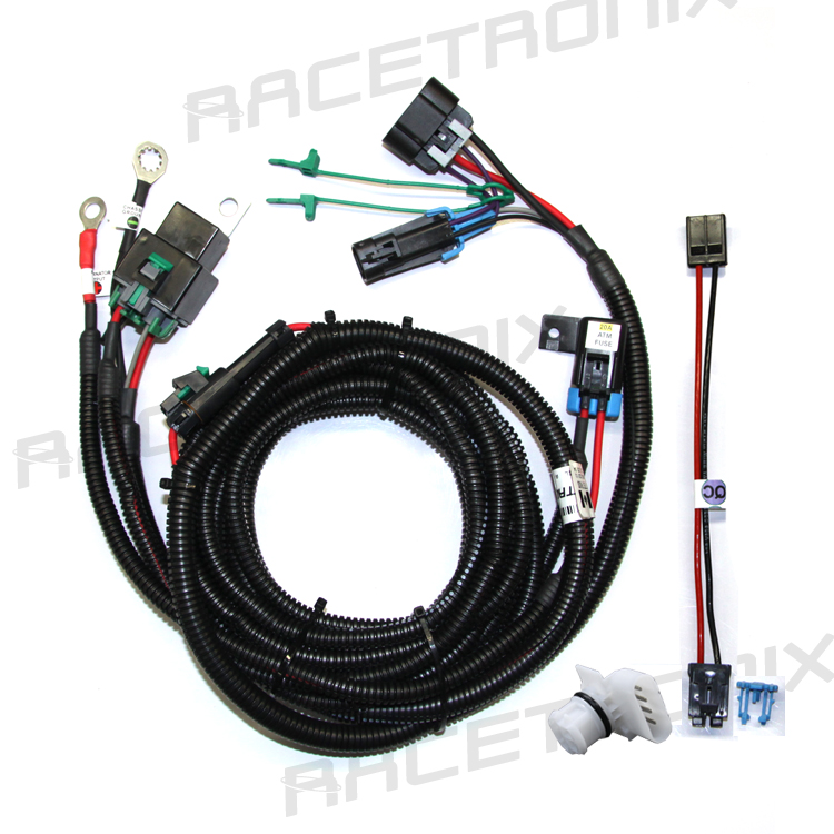

    If you search around there was a deal that Racetronix was giving to LS1 guys for a rewire and new oval connectors. It was and possibly still is being offered at a discount. I picked one up when they still had the promo going, I will see if I can find it still.
    This is the link to it without a discount:
    Racetronix - Fuel Pump Wiring Kit MP150/280, Walbro - Kit Configuration Page
    EDIT- Found it but the code is expired . It is the same thing as the link above though.
    I would still get that (oval connector) harness over the square connectors because they have a tendency to fail and melt.
    Here is a picture (Upgraded oval connector at the bottom right plugs right into the canister hat):
    IIRC some of the 2001's did have a venturi canister in them. It was a year that they put venturi canisters and pumps in some of the cars. If you don't have a venturi pump I believe the pump seal on your canister will not be the same as the one on the venturi canister you will be buying. You will have to make a hybrid canister using the venturi bucket and the hat from the pump that is on your car right now.

    The Racetronix fuel pump rewire is far superior to the ZZP kit especially on a GT.
