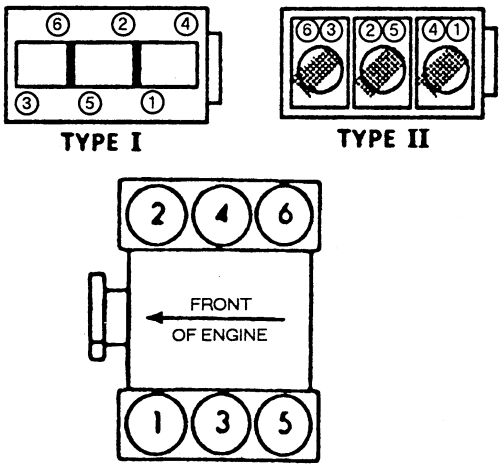

    Sounds like a crossed wire homie, check your vacuum lines and firing order.

    heres the firing order, we are type II and 6 3 is the top coil pack.
