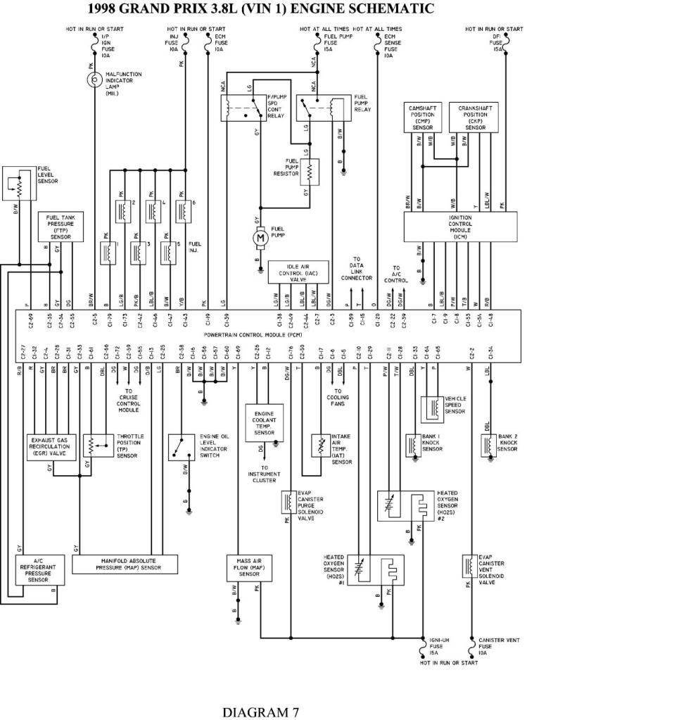

    You can wave a compass in that area. If the needle jumps wildly then the magnet is there. Otherewise you have to take the entire front cover off to inspect. They might be able to see it through the hole for the sensor?
    You can also wave a magnet across the pickup and see if the signal deflects on the scanner.
    Tell them to trace the pickup wire back to the PCM and make sure there's no short or disconnect. There is a pigtail on the front of the motor also; it may be bad.

    icm wiring harness plugs into the cam position sensor. look for a frayed or cut wire in that harness.

    Thanks Swiggles

    thanks rico and swiggles I am going to go out and check it as soon as I can

    ok so I checked it, everything seems to be in order. However it is still not getting fire

    Have you swapped the ICM yet. The signal goes through the ICM before it gets to the PCM.
    Please forgive me if this has already been done and discussed.
