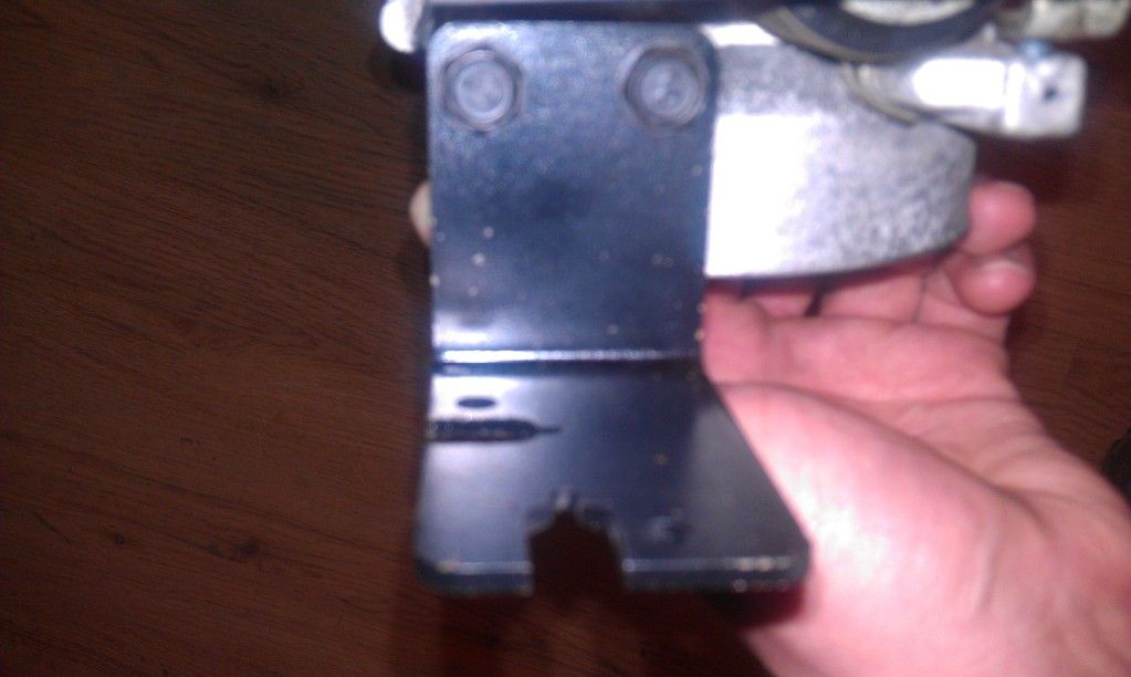

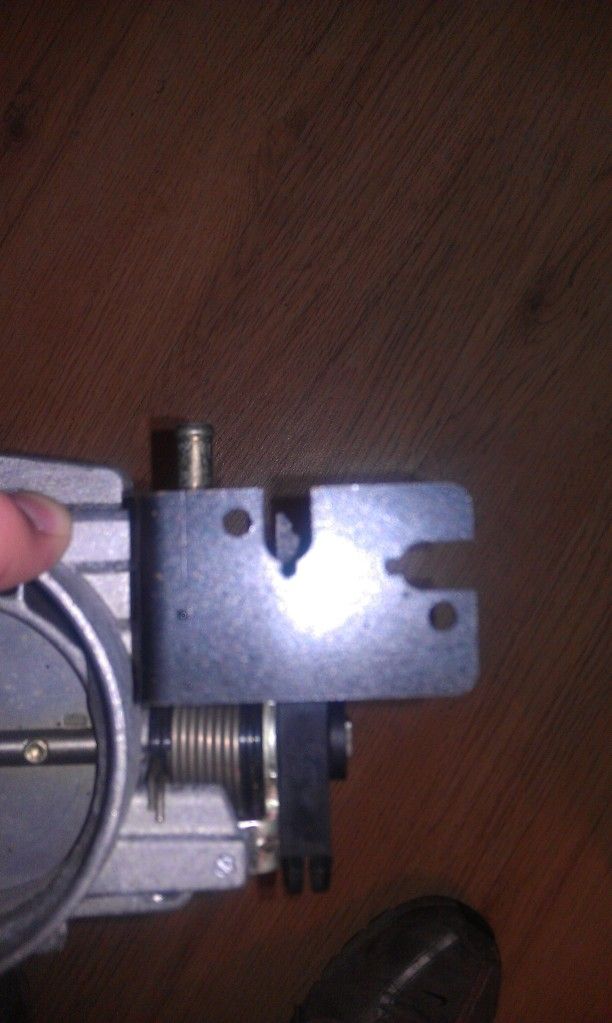

  14. #14 Re: noise after XP install
    Please post pics of the ZZP one.
    I use the original N* one and mod it. I should have a few pics around here somewhere.
    I drill 1/4" through where the N* throttle cable ball would sit and put our cylindrical cable end into it.
    Cut between the throttle and cruise to let them move independently
    And mod where it bolts to the side of the TB to allow the cables to get even closer. Got one to mod at my place right now, maybe I'll get it done this weekend and get pics for you.

  16. #16 Re: noise after XP install
    Lima, OH
    33
    Heres the one ZZP makes which holds the throttle open a little bit. I wouldnt mind using the ZZP one though but might have to make the screw holes wider just to get the throttle to close. Still need an IAC for this throttle body!
