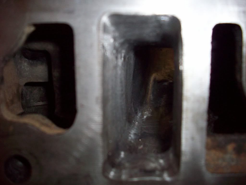

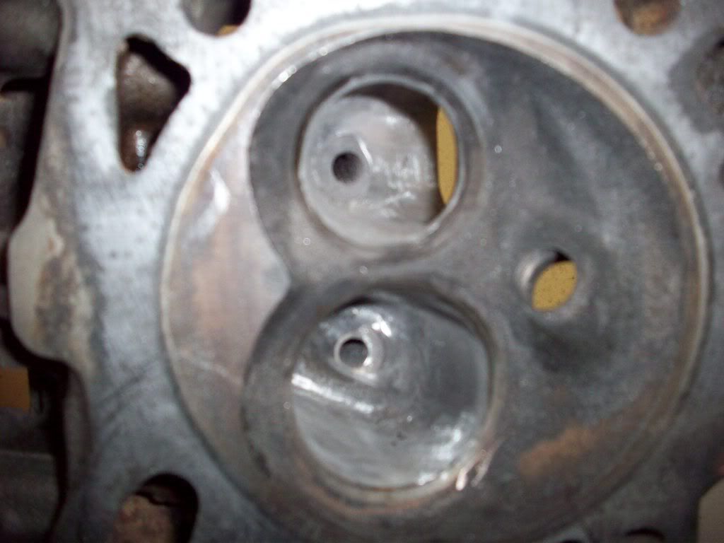

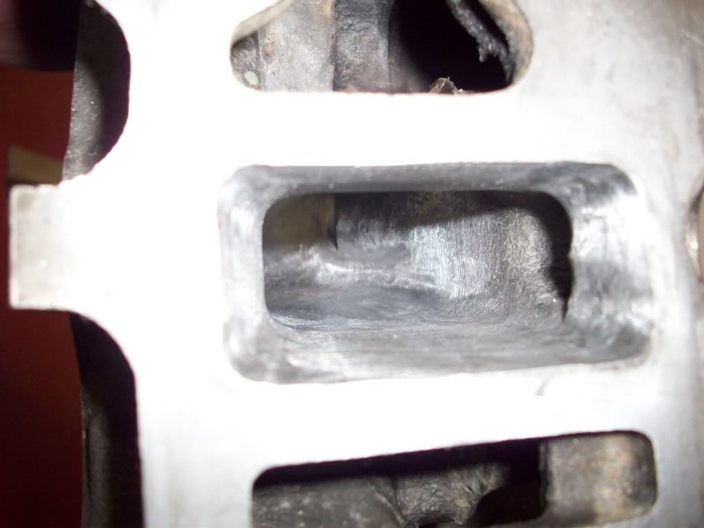

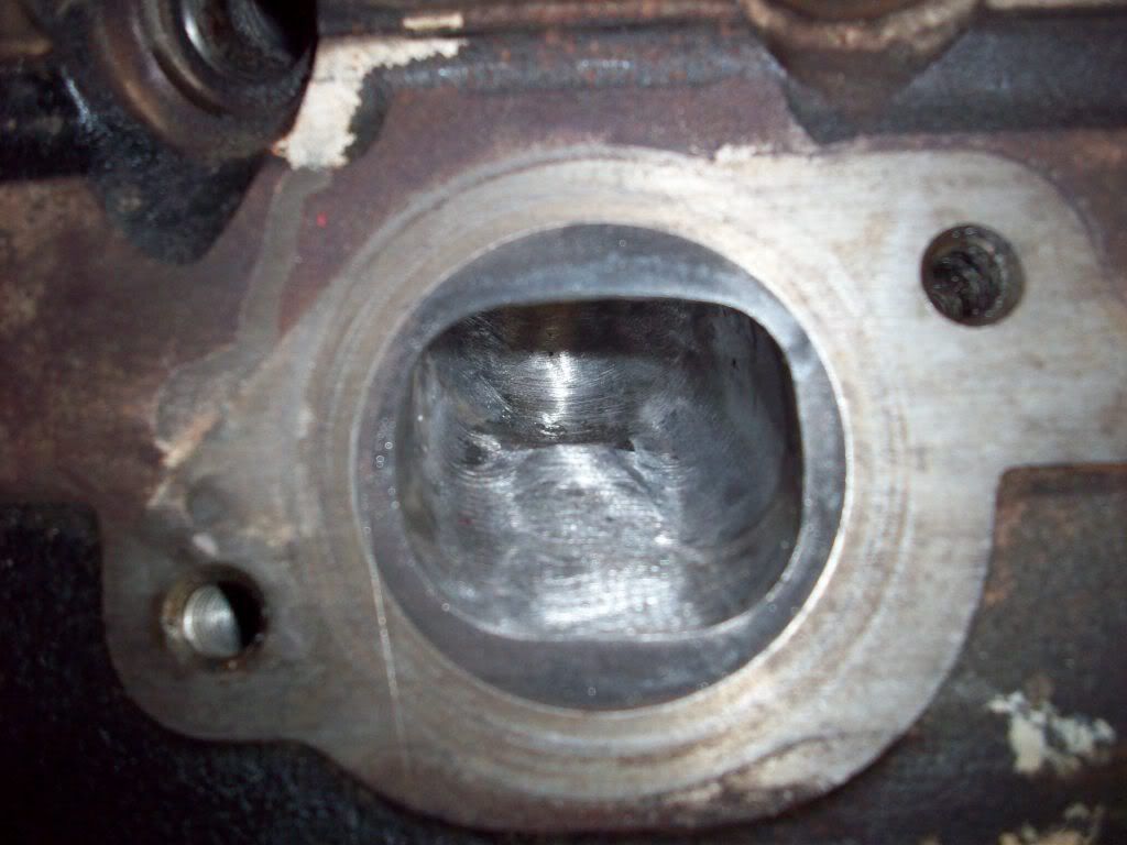

    Here's some shots of the porting I did on the heads, not finished pics unfortunately but you get the idea. Chambers I just started polishing. Again, nothing too rad, just a match port intake and a lil larger on the exhaust, just cleaned things up.
    [IMG][/IMG][IMG][/IMG][IMG][/IMG][IMG][/IMG]

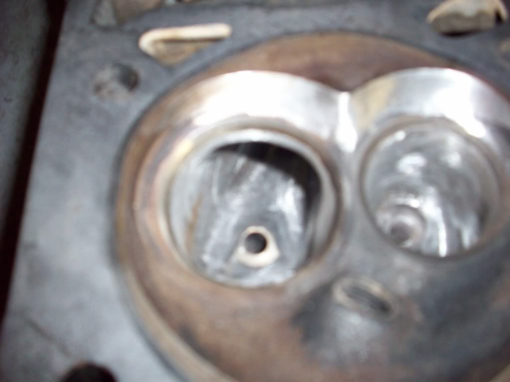

    I wish the pics of the bowls came in a lil clearer, thats where they look really nice, especially after I got them finished. I was pretty jazzed when I took them to Bob's today and he said they looked really good.
    Still mulling over cam choices.............
