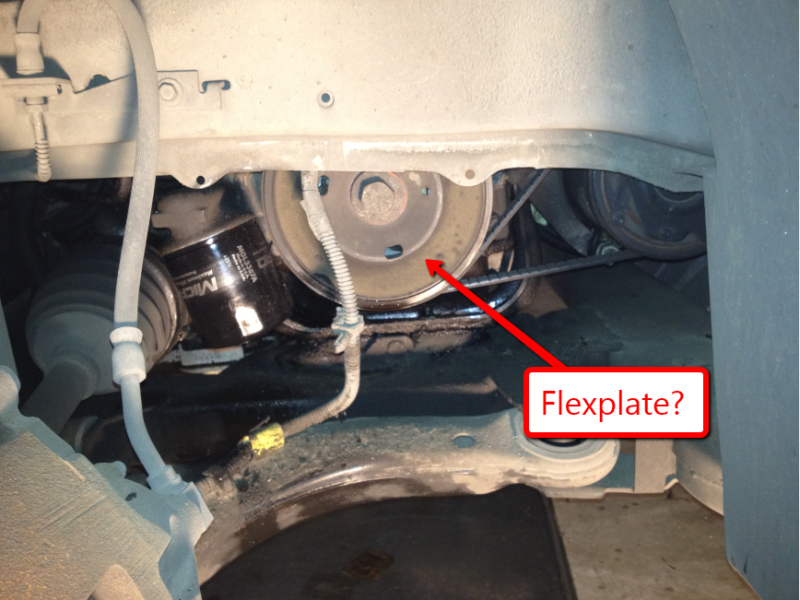

    Quote Originally Posted by sseilmnop View Post
    That is harmonic balancer. The flex plate is other side of engine with the teeth on it for the starter. He jams a extension in it and spins till it jams.
    So where is it on this pic?

    You see the two bolts holding the little plastic cover?

  11. #31 Re: Whats goin on?
    GTP Level Member Rico's Avatar
    Apr 2009
    Fort Worth TX
    1,721
    Bingo!
  12. #32 Re: Whats goin on?
    Lifer h0wl0ngcanitbe's Avatar
    Marysville WA
    805
    Awesome but in order to get this off I have to remove the Transmission Inspection plate? It looks pretty straight forward but im just now mastering the CPS replacement, what should I look out for when removing the Inspection plate?

  13. #33 Re: Whats goin on?
    Apr 2009
    Fort Worth TX
    1,721
    The plate is for accessing the torque convertor bolts. You'll see the flex plate under there. It has the teeth for the starter.
    I find it easier to remove the starter which makes more room for locking the flexplate.
