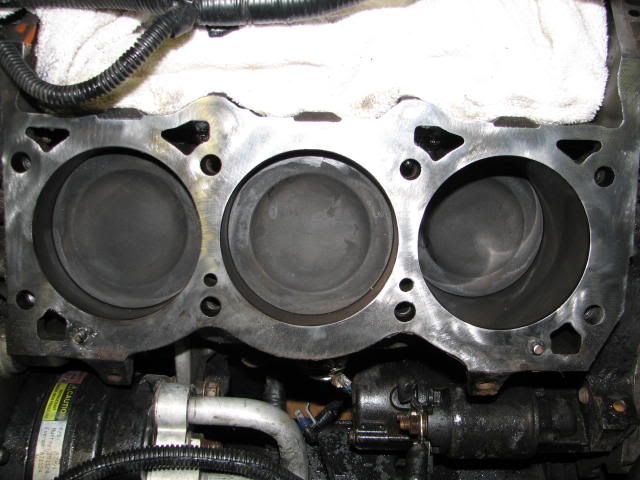

    Ive got some carbon built up on the top of pistons, how do i clean them off? i dont have air tools. please be detailed.
    No more GP 04 Impala SS Indy:
  2. #2 Re: cleaning pistons
    GTP Level Member Bedwards's Avatar
    Calgary, Alberta, Canada
    863
    Soft wire brush (brass) and some carb cleaner or gasket removing spray. Be careful though. If your short block is still assembled, have a shop vac going next to the area to suck up all the carbon/crap, so it doesn't full in between the cylinder wall and piston.

    the motor is out of the car and the heads are off...
    but maybe ill just put it back together and try that method.

    I used a couple shots of brake clean (you know me) and a plastic bristle brush. Didn't take any time and I could read the part number off each one.

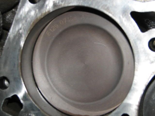

    I might be taking this thread off course a little, but my question is: why?
    I think a thin layer of soot would be much less likely to preigition as opposed to a clean piston top with casting bumps.
    If you have a ton of building such that it might affect your compression ratio or flake off and clog your valves etc, then sure, clean it. If not, I think it doesn't accomplish anything. It will be black again within 30 min of rebuilding.
  18. #18 Re: cleaning pistons
    Our pistons don't have casting bumps. They are smooth and coated.

    ^^Oh this guy...comes through again.
    Ha.
  20. #20 Re: cleaning pistons
    Those aren't casting bumps, those are user errors
