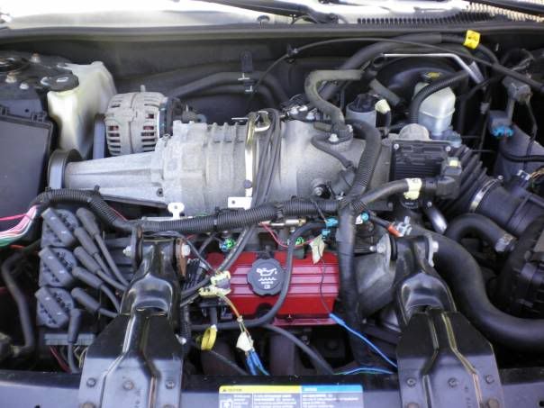

    Bill, there is some wire splicing right in front of the engine compartment thats questionable. It looks like it was half a$$ and sloppy. Not horrible but definitely not professional. I'm not sure why. A couple times a "reduced power" message came up on the dash display and it wouldn't get out of its own way. I shut down the car, restarted it and it ran fine. I'm getting out at noon today. I should be able to get some pics this afternoon so you guys can get a visual. My concern is that the wiring problem could be a costly fix.

    Here is a picture of the engine bay.
    The gallery with all other pics is located at Pictures by aehall2000 - Photobucket

    WoW... That looks like a complete wiring nightmare right there......

    At least its a GenV blower. What are those wires that are butt connected powering?

    They go to the ECU mounted under the airbox
  11. #31 Re: Engine conversion kit
    Houston
    2,841
    Find out what pin #'s they go to. Im sure theres a PCM pinout around here somewhere. Or Bill will know it by heart.

    all of those butt splice connectors need to be removed, and then soldered, and shrink wrapped to even come close to working properly. you have a bit of a mess there.
    are the wires to the maf twist tied? with nothing at all on them? hard to tell from the pic.
    i bet it runs real bad when its raining out.

    Sorry man, I'm not sure what you're lookin at. It is a bit of a mess. I'm curious what who ever did the work was thinkin. Why the splicing and what was he tryin to accomplish. Seems sloppy and careless. Why spend all the money and time going that far into a modification and then mincemeat the electrical. Don't get it
