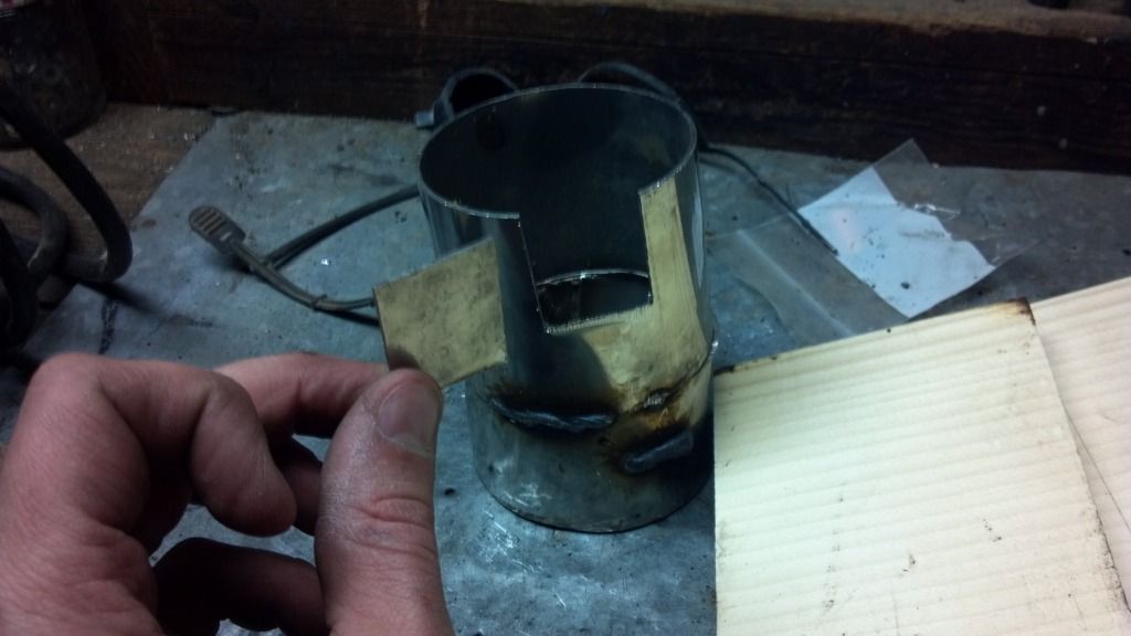

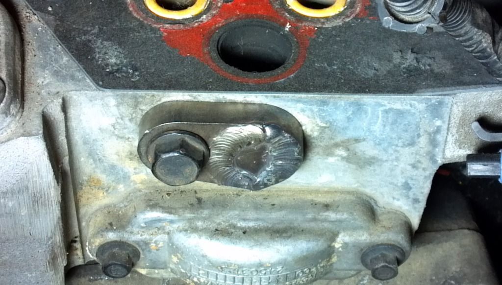

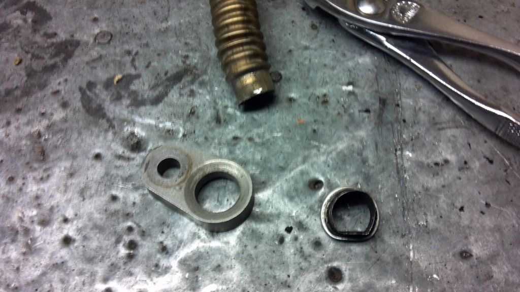

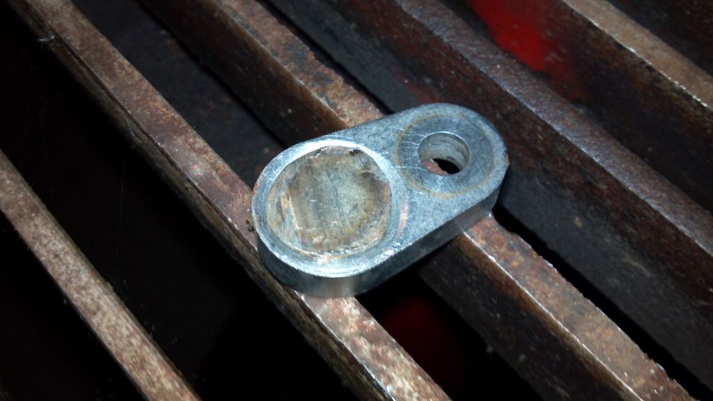

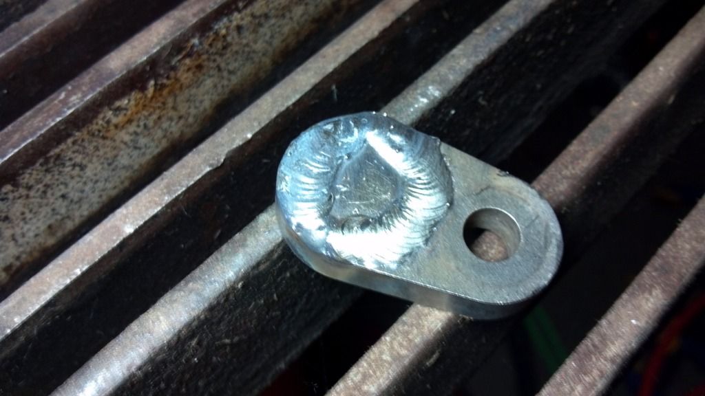

  5. #5 Re: EGR delete
    May 2008
    Schuyler, NE
    2,972
    8
    23
    Here's what I did.
    Just cut the stock flange off the EGR.
    Cut a piece out of a chunk of stainless pipe and shaped it to fit the opening.
    And welded it up.
    I also installed it with some RTV because I don't think it will seal if you don't.
