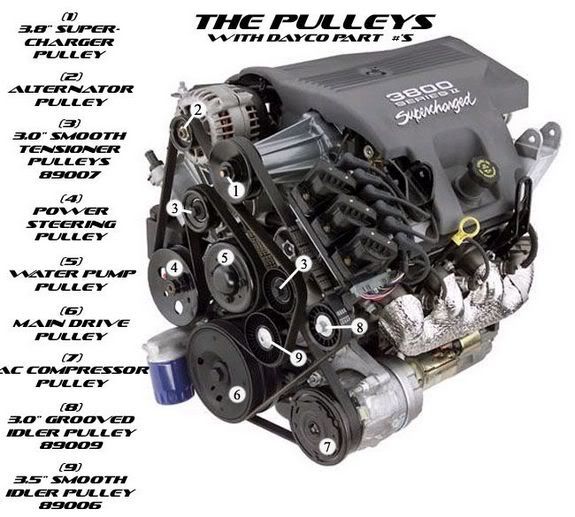

    So i was driving today, and then all of a sudden I had NO boost. So I popped the hood and my supercharger belt was just chillin there. So I bought a new belt, figuring the old one was just worn out, went to go put it on and pulley #9 was missing and there was a bunch of rubber shavings next to where the pulley would be:
    this is what it looked like:
    srry for the crappy quality.
    hopefully when I replace the part tomorrow, it fixes the problem.

    yup, that would probably create a loud squeal..................lol!

    pulley and belt replaced...squeal fixed
