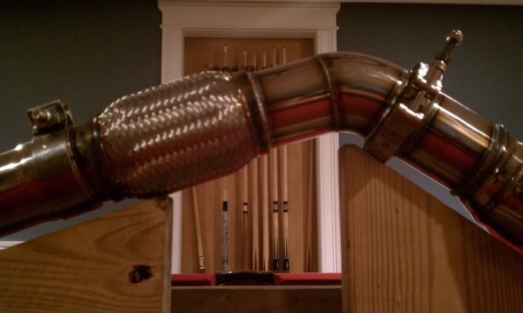

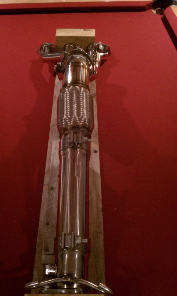

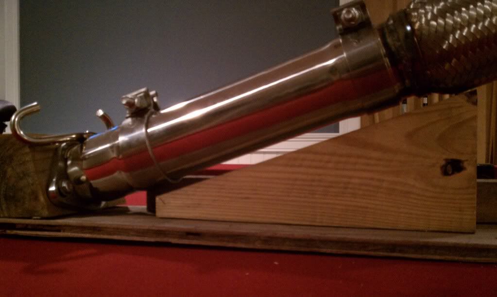

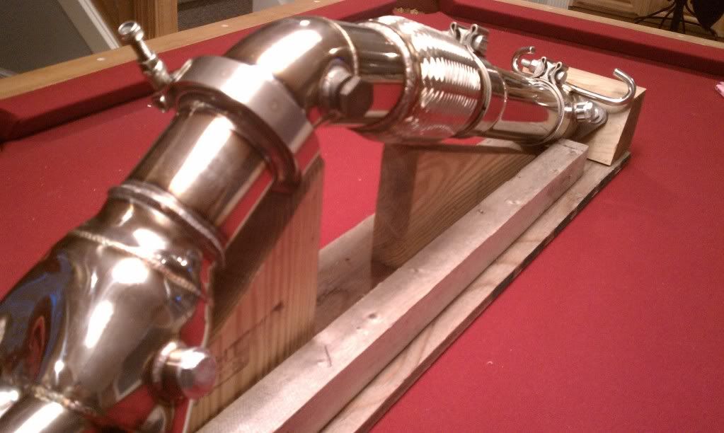

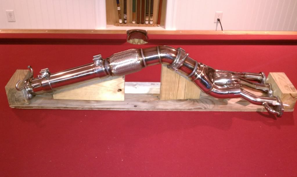

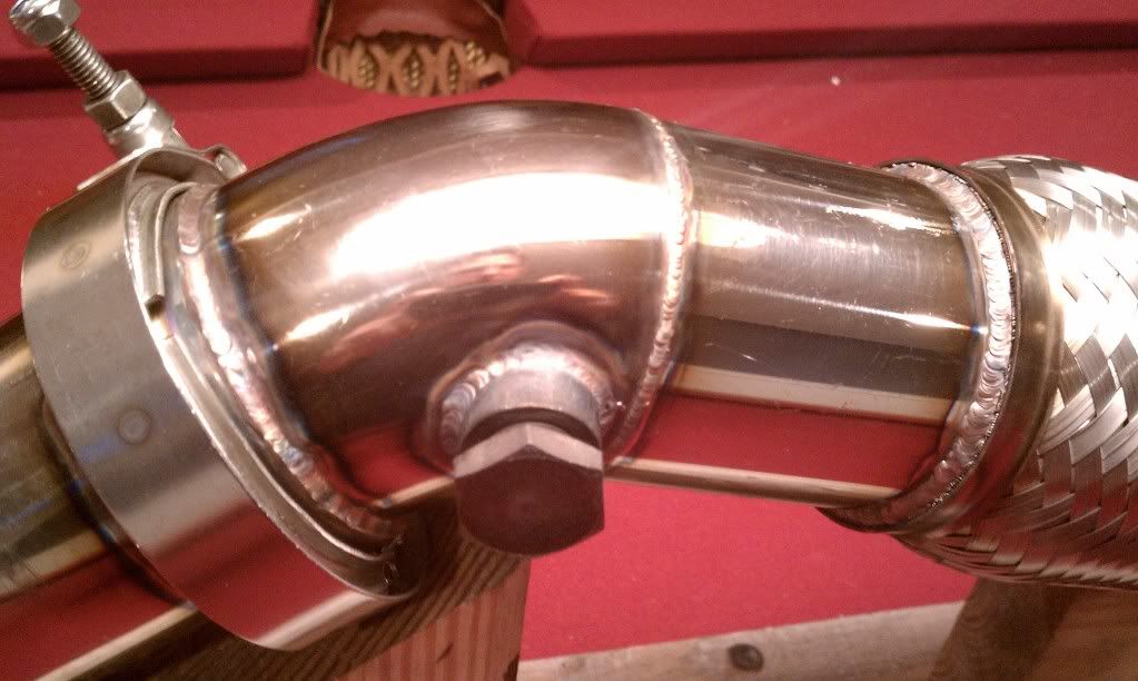

    SilverGTP on here was nice enough to let me use his jig for the speed daddy headers. Here are some pictures of the finished product. Headers are going on the grand prix this Friday. I thought it came out well.

    Wtf are the bolts for?
    And can you make a diagram of that jig with mesurments and assembly instructions for the rest of the class?

    All I did to make that jig was to assemble the rear header and downpipe assembly then grab some scrap wood and build around it. Once you have it lagged in place, start cutting the middle out and weld it back together how you want. The pics above are very nice work.

    Those bolts are plugs for where my narrowband and wideband sensors go.

    nice job, very clean welds.
    I hope you replaced that flex tho, its gunna tick and leak within a while.

    the sd's come with a single walled flex pipe that over time will blow out and cause the tick sounds.
    I replaced it with a double walled 3in ZZP flex pipe to never have the issue.
    Tho, some people say they never have an issue with just throwing the SD's in just the way they are, but I didnt want to chance that.

    The flex was replaced with a ZZP interlock, wideband bung added, still used the original v-band but I purchased Torca accuseal clamps.

    Quote Originally Posted by intrigue98 View Post
    Good man.
    The 3in one correct?

    Yes, 3"

    That's just about how I wanted to redo the SD Headers I picked up. It looks so good, I might even redo my SLP headers for my other car. Where'd you get your clamps from? Did you TIG or MIG weld them? Let us know of any bottoming issues.

    Well, first I got the 3" torca clamps off of ebay for about 11 shipped each. I then found out that frozenboost sells "torca style" stainless clamps and went with them for the 2.25" crossover clamps. Frozenboost is the cheapest (4.99 each + shipping) and shipping only took 2 business days (USPS First Class).
