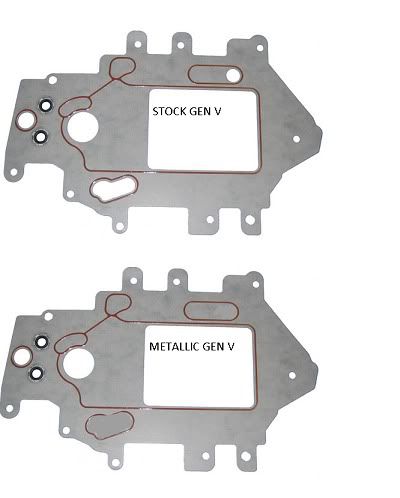

    The gen V I have came with this metallic gasket, I've always avoided using these so during orignal install I purchased a new one.
    I got desperate and when I put my motor back together I used it. Below is a picture of what the gasket looks like vs a normal. I am going to attempt to salvage the older one temporarily and put it back in becase I'm getting a lean fuel trim and misfire code.
    Does anyone know if there is a purpose for this or should I just go ahead and drill it out so I can make use of it.

    You need a hole there for the pcv. Or you will have tons of issues.

    does the part store consider that the non street legal gasket?

    Those aluminum gaskets are junk, throw it away and buy the 04/05 gasket from GM.
