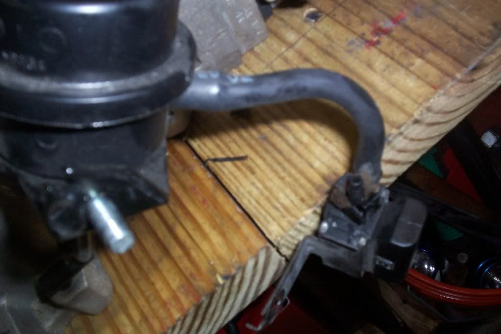

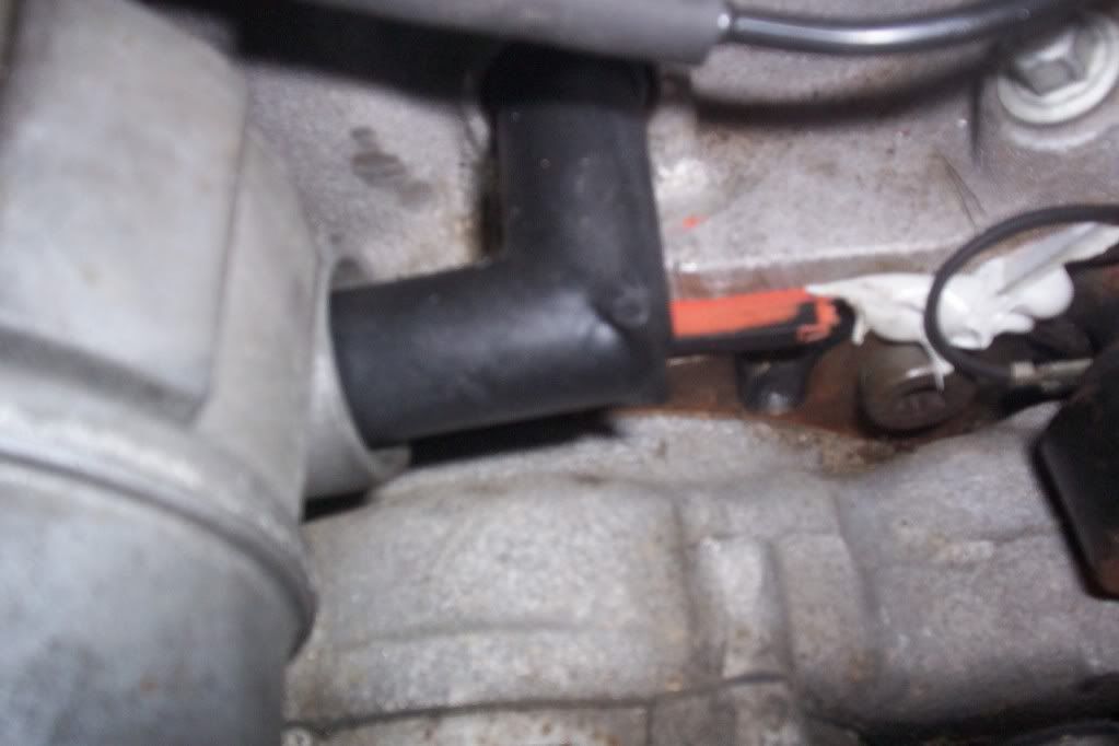

    im swapping cases and have a few question. i had the lim done at the dealer about 6 mounths ago and it looks like the gasket is hanging out
    also i noticed this sensor has what looks like 3 vacum lines and only 2 lines were on it.

    Does the LIM leak at all? If not, leave it.
    Not sure on the 2nd pic.

    Everything looks perfectly normal to me. The LIM gasket does overhang just a little bit, and the RTV is for the gaps in the corners where the gaskets butt together. On the BBV solenoid, there should only be one hose going to that vacuum pod, the other nipple needs to be open to the atmosphere.
