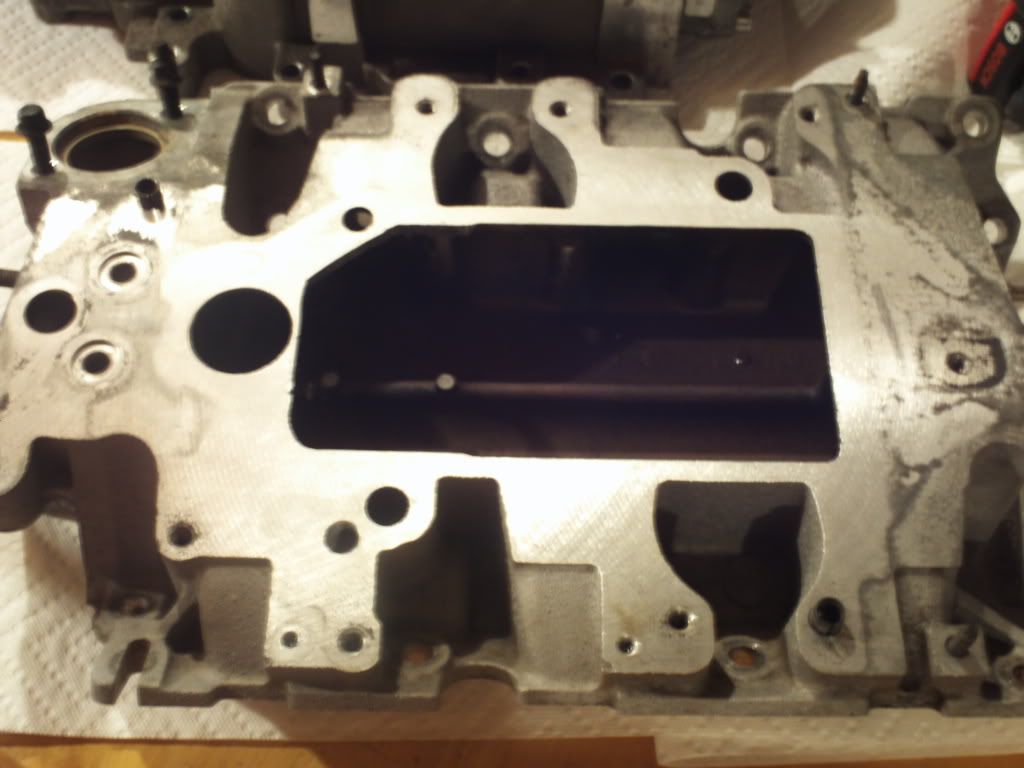

    so i got the car running, currently on the stock injectors, i'll get 42#'s before it hits the streets but, besides the loop of the cam, im getting fluctuating rpm's as you can see in the video. I am running a breather and i made a hole in the lim for proper pcv. Is this a vacuum leak? is it because im running a breather? It was so bad the car stalled a few times when i put it from Park to Drive. Any ideas?

    I don't get how you could drill it properly for pcv but yet have a breather on the front. Put the oil cap back on, if it starts sucking or you notice vaccum when you take the cap off, then put the breather on.

    You can also put your hand over the hole, and if the PCV isn't functioning properly, you'll immediately feel a vacuum pull on the palm of your hand.
  11. #11 Re: xp cam fluctuating rpm
    26,833
    With a functioning pcv, a breather is a vacuum leak.
    Think about how pcv works... I'd cap it for the time being.

    ^ i made the hole slightly over a little so it lines up with the intercooler
    i must have read wrong or something, i thought i needed a breather still. I'll give your suggestions a shot. Thanks guys
