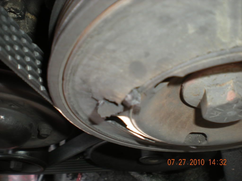

    Alright heres the deal im at the gas station and suddenly there is this clicking kinda noise coming out of my engine i get out and look it sounds like its coming from the belt area.
    I drive home like 3 blocks and it stops when not at idle turn the car off and look under hood the rubber on the harmonic balancer looks like part of it exploded and it wasnt like that before .
    My question is about the new balancer for sale on rock auto the one by acdelco says new key required. so i cant use the old one?
    also any tips or would be great because iv never changed one before.
    Thanks in advance.

    I know you guys are picture whores so here is some pics of the damage
    http://i930.photobucket.com/albums/a...CN2305_002.jpg
    http://i930.photobucket.com/albums/a...CN2304_003.jpg
    http://i930.photobucket.com/albums/a...CN2303_001.jpg

    one like this, but go to autozone or advance etc....They are like 15 bucks there then go to the hardware store and get 3 grade 8 1/4-20 bolts that are like 100mm long.

    thanks for the offer bill but i already ordered one
    and i will deff piece together my own puller thanks for the specs

    Technically the puller bolts are M6 x 1.00 x 80mm (if you go longer on a GP, you tend to have the body int he way. The 1/4's will work fine because the overall threads etc are close.

    got it fixed ended up using 1/4-28 bolts the m6s wouldn't thread all the way in and did not try the 1/4 20s
