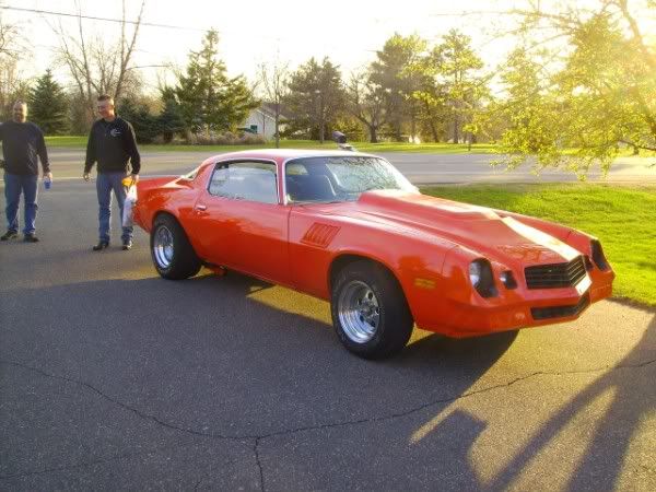

    Oh and what year is that maro? Pic's too small to appreciate anything else.

    I live out in the sticks, so it's going to be hard for me to find a shop to tune it for me. Most of the stuff out here is either dirt track or muscle cars. I'll have to check in the Minneapolis area see what I can find. Otherwise I've read mostly good things about intense and 3800performance, I'll have to look into that as well. I wouldn't mind sending it to someone,but my camaro is my only other vehicle and single digit gas mileage would be a little rough on the commute to work. So it's looking like headers, ecm, CAI, thermostat, colder plugs, and then pulley swap. Anything else I should be looking at? I should have enough cash by next week to start picking up parts. I'm not looking to do a cam or rockers, don't feel like pulling it apart that far. I've done enough cam swaps on my chevy. The Camaro is an '81 with a 78 front end on it. It's got a 388 small block with an automatic. Here's a better pic:
    Don't mind the stance, at the time I had just put new springs in and they hadn't settled yet.
