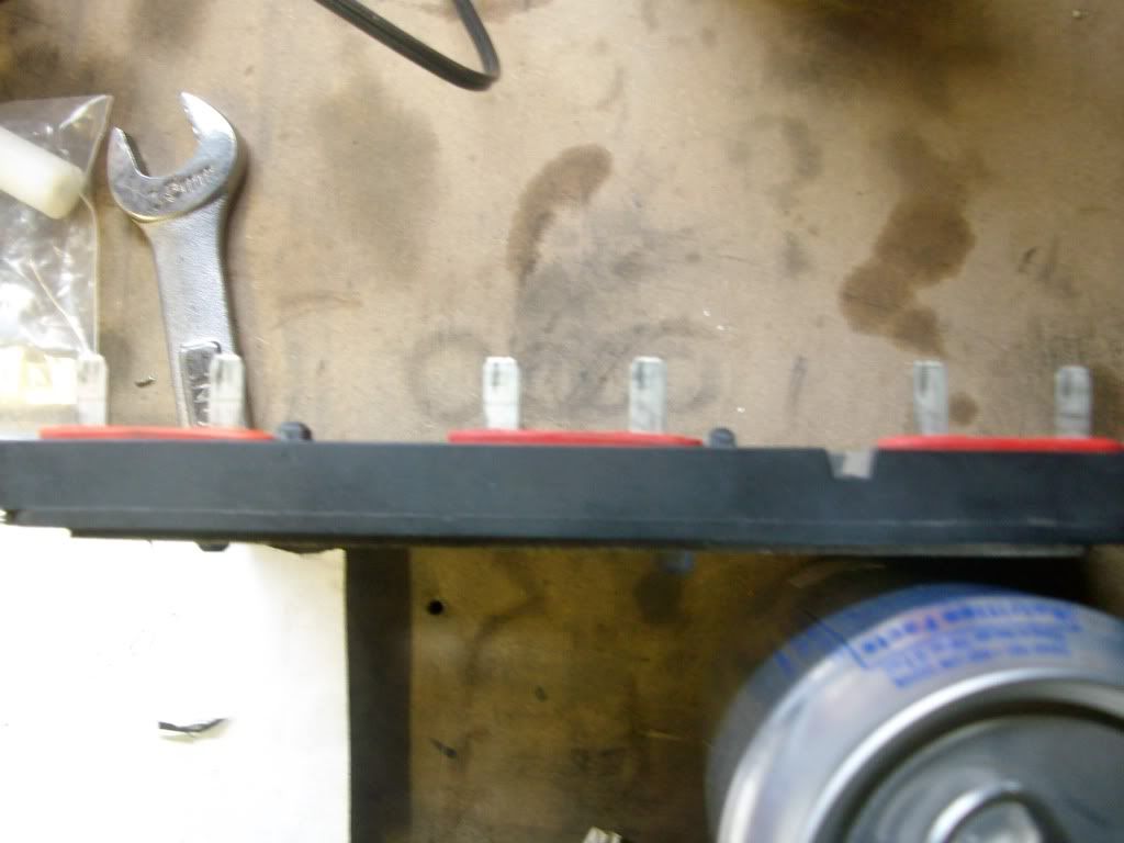

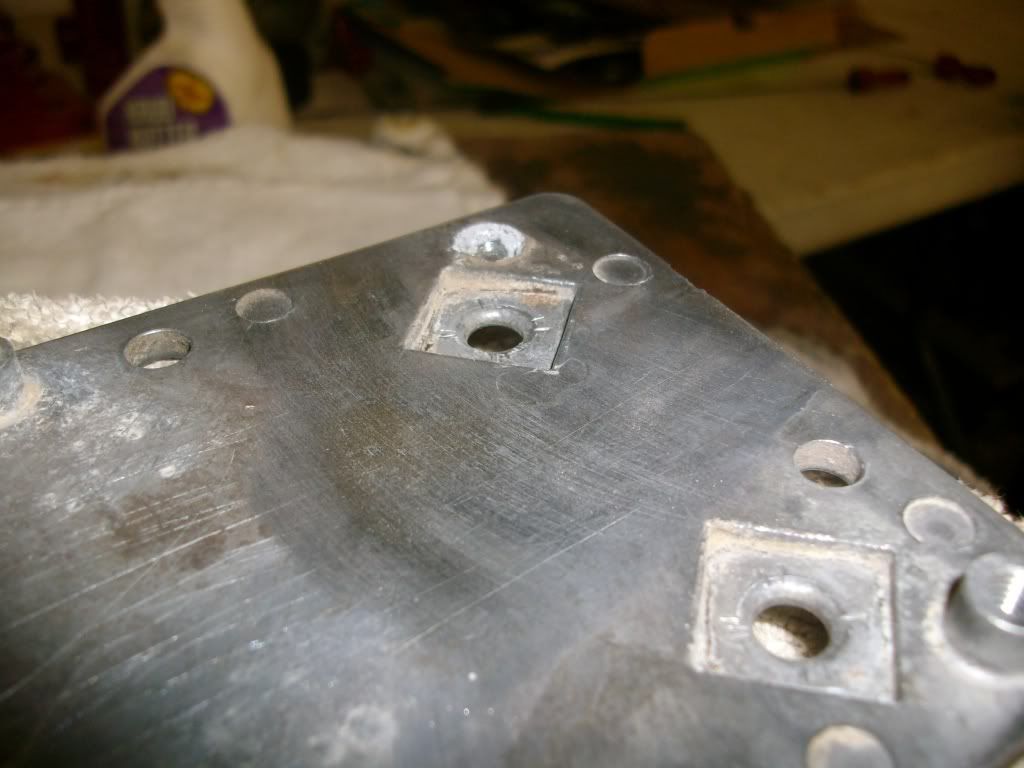

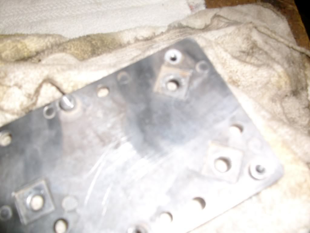

    heres what i was talking about. i meant the icm bracket.

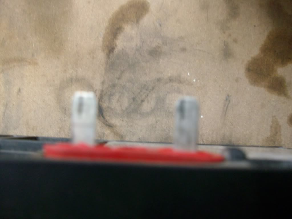

    is this what is called "carbon tracking" on the prongs of the icm?
