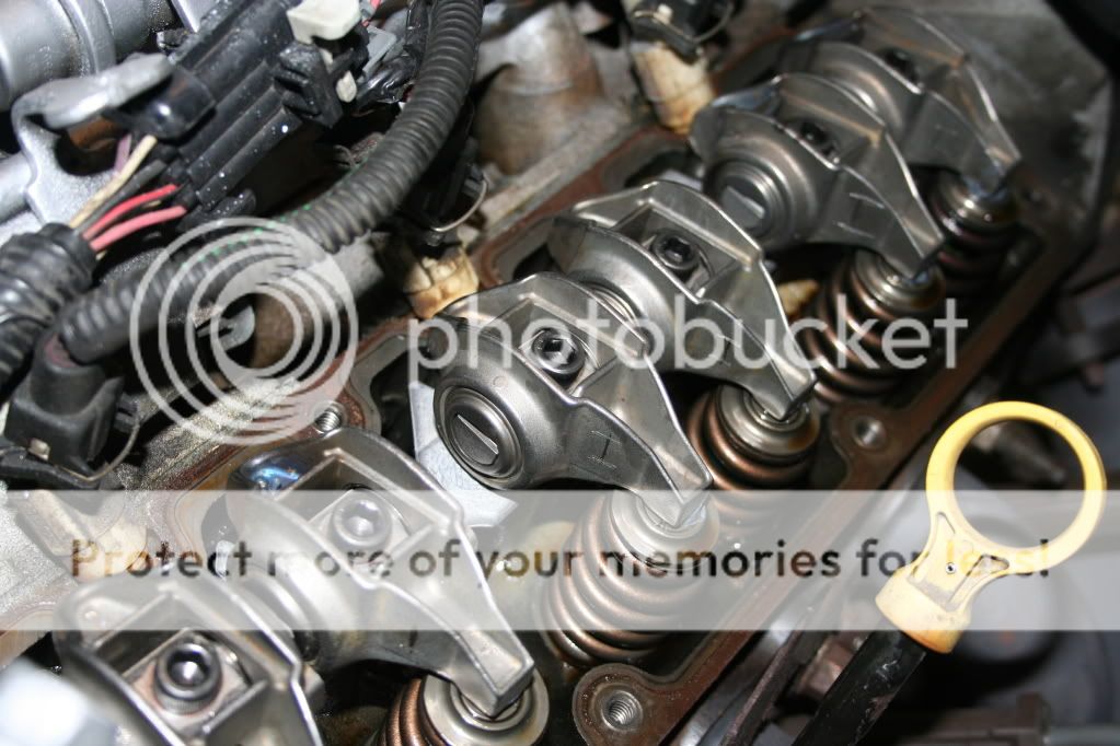

    Hard to see in that pic. Maybe Mini can tell. I know mine all had an "I" engraved on the side

    im going to go out on a limb and say that the "I" stands for intake, as the split ratio rockers for the NA motor are 1.9 on the intake and 1.85 for the exhaust.

    you can clearly see that the seat is moved in farther therefore modified.
    Wouldn't the seat be moved out rather than in to achieve a higher ratio?

    Actually, no....moving it in toward the center raises the ratio. Those are modified rockers.
    Thanks, after putting some thought into it that makes sense.
