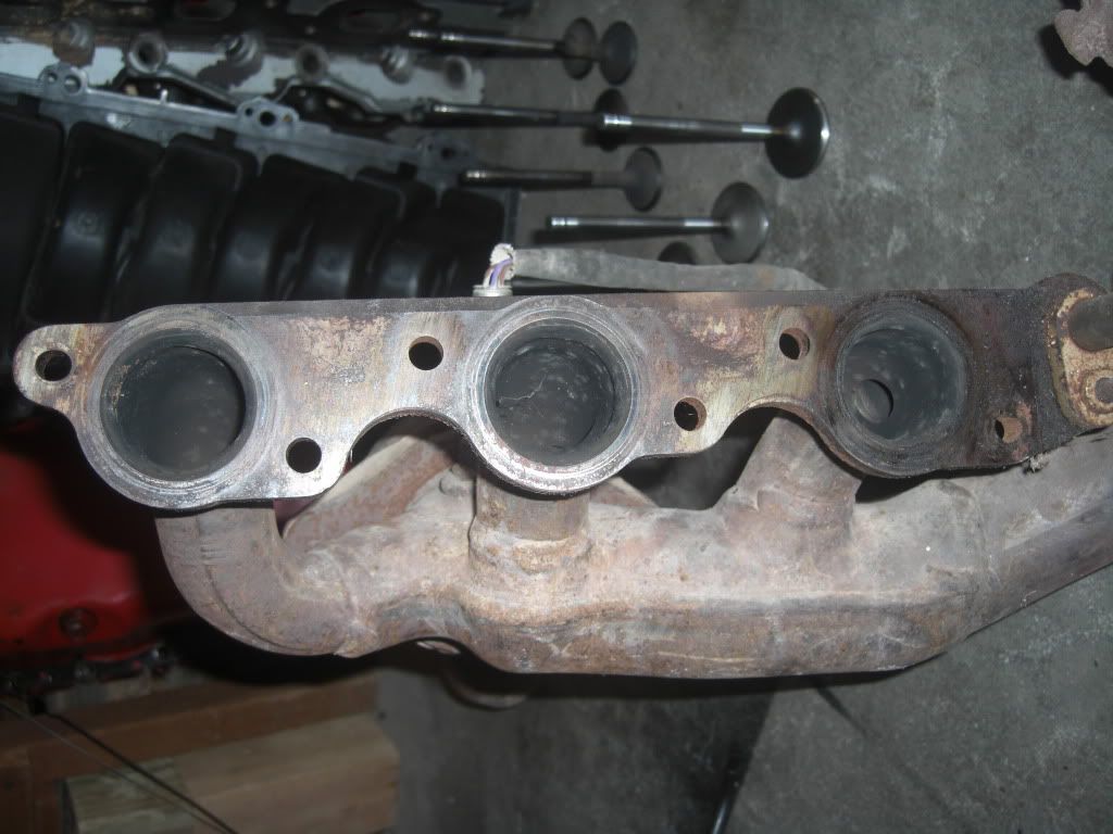

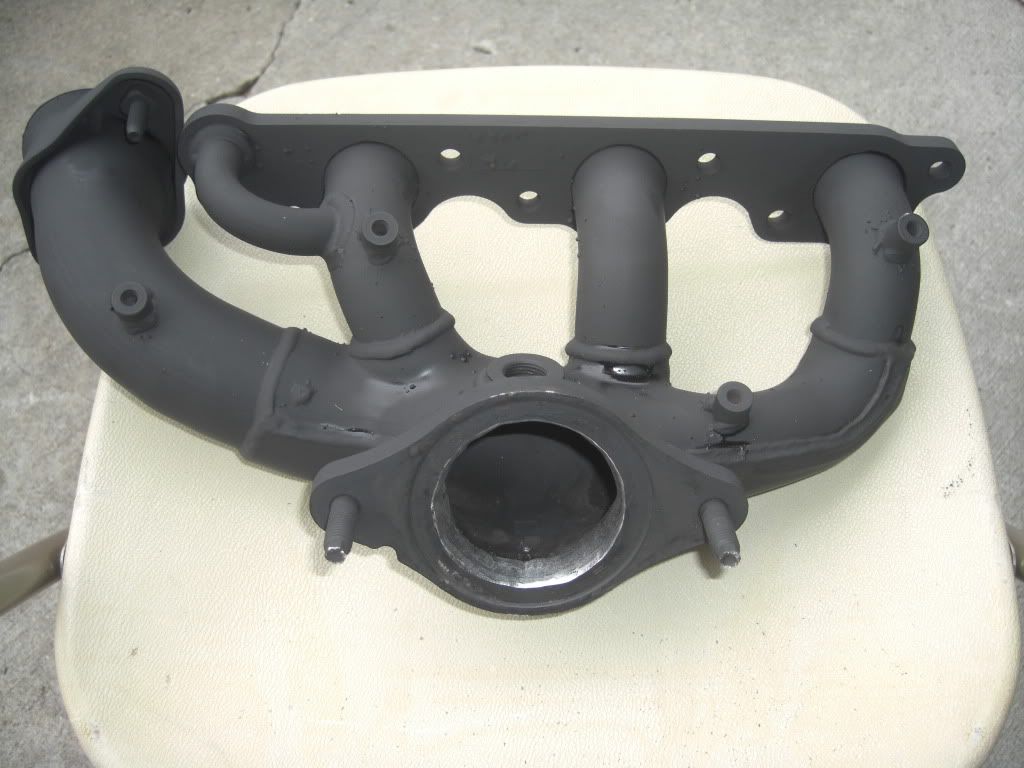

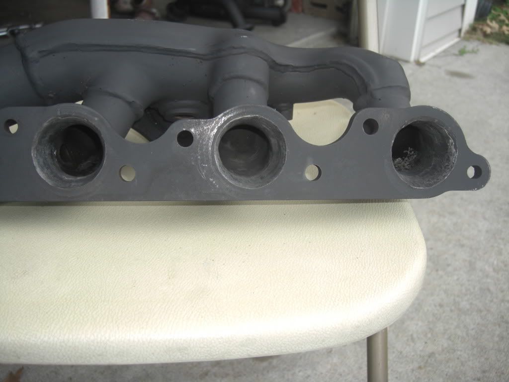

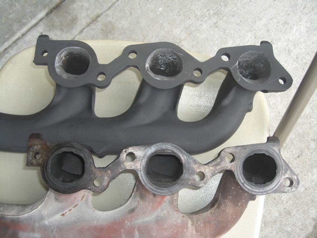

I'd hope so...put a 3.6" on there if you've got it. And since its free...hog out your front manifold. It'll help it flow a bit better for FREE...did I mention it won't cost you anything? Did those for a guy with a L67 Monte...heat treated with 2000* black coating. Took me about an hour to the front and rear...
Fronts...
Stock Rear...
Ported Rear (Front)...
Ported Rear (DP side)...
