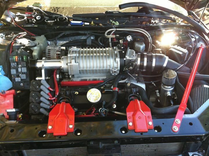

    Just a pointer...it's a PITA to fit a regular GenIII M90 in an FBody without MAJOR modifications to the blower case...just think about a taller, wider, and longer M112 hybrid blower...sure would be cool if you did it.
    just wondering how a m112 hybrid is taller and wider when it uses a m90 case and even with the spacer the m112 snout is shorter the a m90 just a thought

    The blower is the same size all around It uses the original case and the snout comes out to the same spot so overall it's the same size

    its not the blower, but the lower plate that is needed to match the new outlet to the lower intake. basically the height of a SSIC im guessing... add to that a full IC. which if you need a m112 hybrid you must have already... that is where the extra height is coming from i think

    There is no lower plate that needs to be matched. AN M112 Hybrid is M112 Cobra/Lighting rotors/snout in an M90 case. It's the original s/c case and mounts up fine. It's the same width, height, depth, and length due to having to be lined up with the rest of the belt.
    Not sure where Nick thinks the M112 Hybrid blower are bigger...unless im missing something?

    the case needs to move because the rotor pack is longer. the belts wont line up if you just bolt it on.

    you need an adapter to move the outlet of the case closer to the drivers side of the motor, otherwise the rotor pack being longer will make the pulleys not line up. it doesnt just bolt right on where the old m90 case bolted on.

    i was assuming the rotor pack and snout were longer total length than that of an m90. i stand corrected.

    The rotors of the m112 are longer but the snout is shorter so it works out

    hmm... I see he used pics of MY engine bay in his ebay ad... Wonder why he didnt take his own pictures witht he setup on his car... This is my old project. I sold it to him, and now he's reselling it. If your wondering about the price, its a steal. If you use a ZZP pulley system/pulley, it puts the belt closer to the supercharger, allowing you to run without issue.
