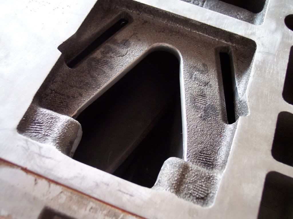

    http://i158.photobucket.com/albums/t...0/100_3422.jpg
    ANyone ever try deleting the "v" and making the whole opening square (taking out the silencer slits)like the intake manifold? Then the sc case will match the square intake manifold opening.
  7. #7 Re: m90 Rotors
    GTP Level Member Scimmia's Avatar
    QCA, IA
    1,054
    Quote Originally Posted by Lion29GTP View Post
    The way these rotors are set up, that would make the case totally useless. It would be sucking the air from the LIM back into the SC.
    that V works with the rotors to actually make boost. if you open it up i would be surprised if you saw 1 pound of boost ever. you would totally destroy the case doing that. just extended the V so it doesnt have those stupid square parts in the cornor, but keep the same angle.
    the angle matches the rotors.

    just make it look like this, or i could do it for you.
  10. #10 Re: m90 Rotors
    Jan 2009
    Long Island
    117
    I did one before like this before and it came out great. Thank You.

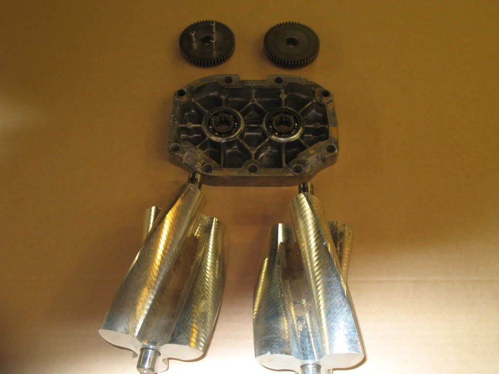

    posting this for Lion
    [IMG][/IMG]
    [IMG][/IMG]
    Thank you for the Post!!

    19
    holy ****! how did those rotors get like that!
    Pretty Shinny = NO BOOST
  16. #16 Re: m90 Rotors
    Quote Originally Posted by makdaddy View Post
    pretty shinny = no boost
    yup!!
  17. #17 Re: m90 Rotors
    Banned - Busted For Scamming
    Feb 2009
    32812
    3,060
    once they get a nick in them, the powder coating flakes off.
