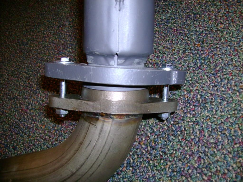

test fit:
http://img.photobucket.com/albums/v3...2/DSC02403.jpg
another test fit:
http://img.photobucket.com/albums/v3...2/DSC02402.jpg
and installed:
http://img.photobucket.com/albums/v3...2/DSC02410.jpg
