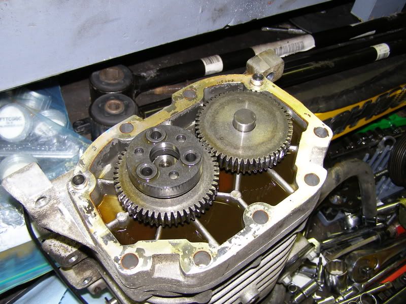

    the rattle you are hearing is the SC coupler inside the snout. all you would require is a new coupler, and 2 bottle of SC fluid.
    ZZP has both I believe.
    Here it is... the round thing:
    the snout just slides into it..see the 3 pins:

    The coupler is the round piece in the first pic with the three holes. It actually has six holes. Three for the rotors' pegs to slide into, and three for the snout's pegs to slide into. It joins them so the snout can drive the rotors. Hence it being called a "coupler".
