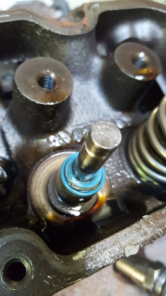

    in bulley flows defense, he deleted his posts, but i could read them, the guy who bought those heads had more work done to them after the fact. iirc he recommended he not do what he wanted with what ever cam rockers set up or some crap. and theres the result.
    how true that is, idk really.
    you can check that easy enough tho, just grab the spring top and see if it moves when pushed on side to side. the seal would also be trashed if the stem was to move that much like in the pic posted.

    Honestly I just posted to pic to illustrate why it could be smoking and not have a damaged seal. Obviously if it was as bad as in the pic the the seal would be toast as well, but I have seen worn out valve guides that caused the engine to smoke but didn't show see the damage to the seal.

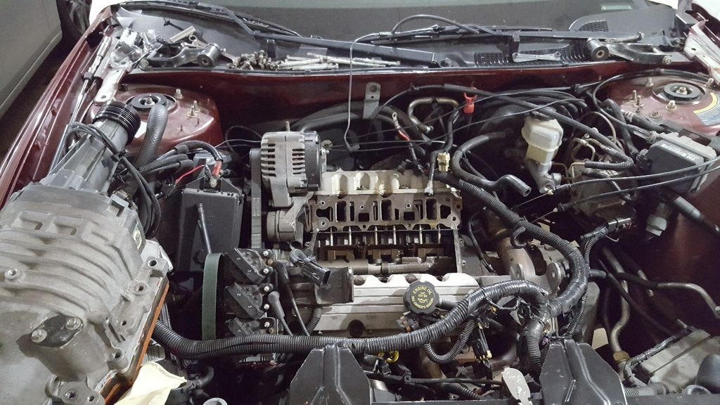

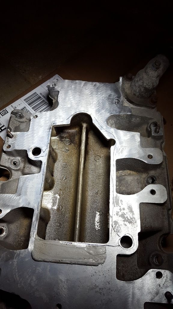

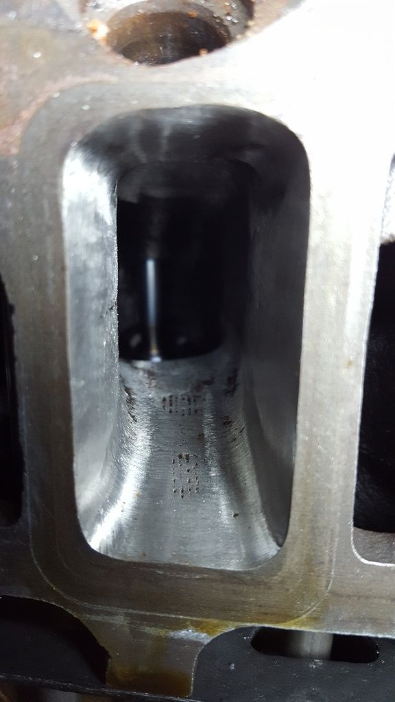

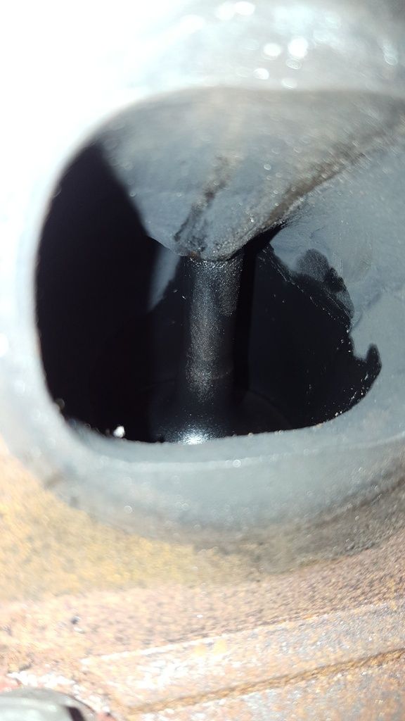

    Removed the LIM and the biggest affected cyl (#2) is dry at least on the intake side. I'd expect a bad head or bad valve seal when I get it off and to the machine shop. Per the last diag I hope rings can ruled out. But too much oil could have killed them. But I don't know. Besides that the entire LIM is slightly damp with oil. Is there anyway to prevent this? I have a hose from the oil cap to the air intake tube after the maf.

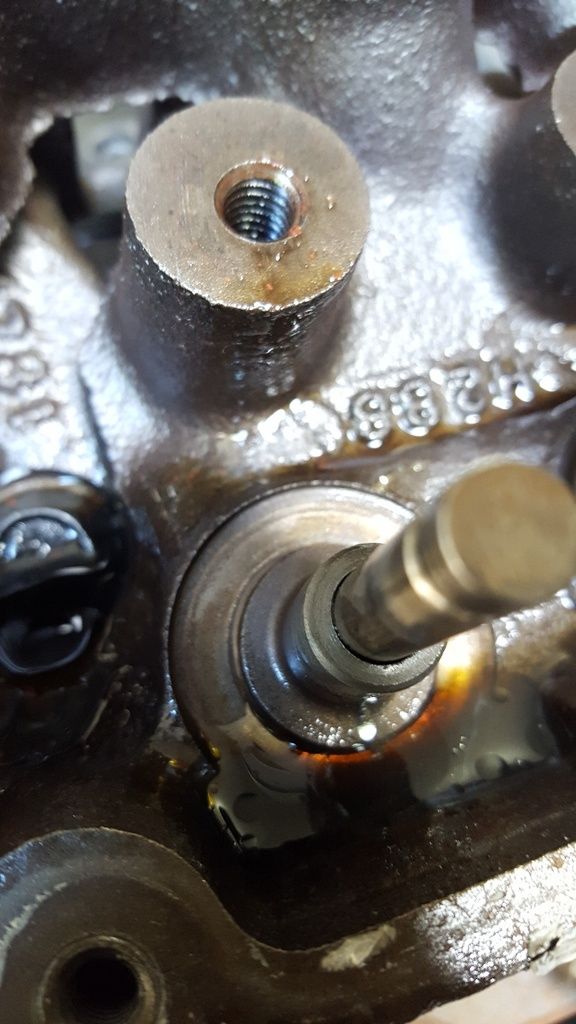

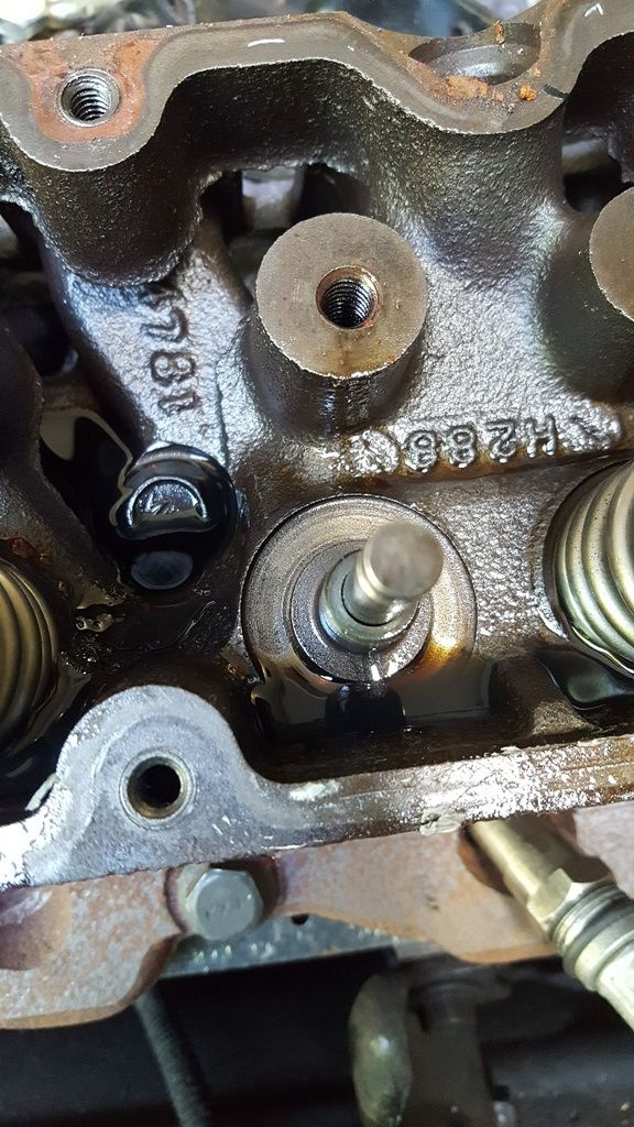

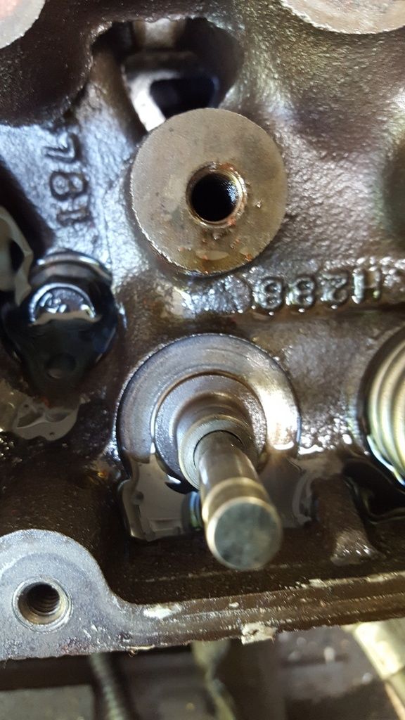

    Here is a video of what all my exhaust valves sound like when air is hooked up EXCEPT #2 which as you see is SOAKED with oil from the valve seal. The spring is definitely deformed. What is everyone's opinion on the seat it self? They were all ground down to accept I high lift cam at least I hope they were. But is there too much gap between the stem and the actual seat??
    https://www.youtube.com/watch?v=SBlxu1J3zXo
    As you can see #2 is not the only affected cylinder that is getting oil seepage...
    LOL I cant believe I just missed this. But literally any cylinder that's on the exhaust side that's wet with oil the spring is not perfectly true it is deformed to some extent but #2 was the worst!

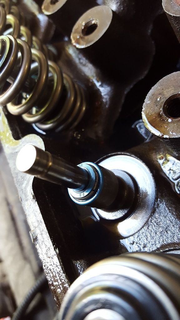

    My next dilemma is should I use the valve seals again from intense "Machined (0.500")" or the ZZP ones? The intense one has a spring while the zzp one has a heavy duty looking band per pictures on the site.
