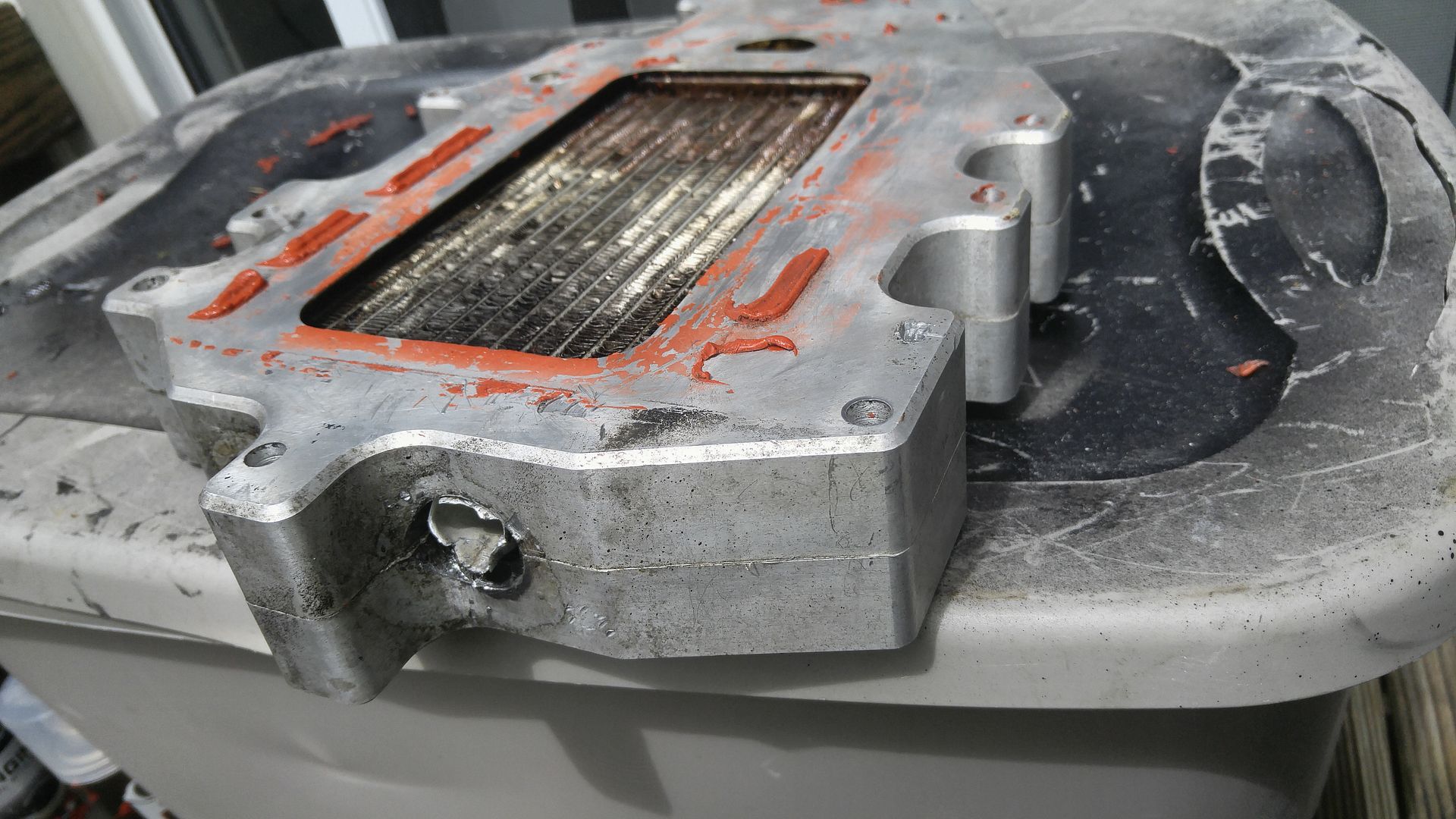

    Trying to open up my wbs intercooler core housing ...anybody got any tips ..I see taps on the side ..but rtv on this thing is tough I stripped quick smh

    A bigass screwdriver and apply pressure slowly and give it a chance to separate.
  3. #3 Re: Tips on how too open heat intercooler core?
    A picture might help a ton here. I had a wbs core and there wasn't a way to open it.. as it was a solid piece.
    Her she be you see I've all ready beat her up scared now cause don't got 650 laying around for a new one

    Imma get home and post a pic ...its gotta come apart its got a crease line all the way around it and grey rtv along the edges

    [IMG][/IMG]
  7. #7 Re: Tips on how too open heat intercooler core?
    39,929
    your core tubes break off?
    id get a thin putty knife to start with, and pick a corner to start love tapping it in between the two 1/2's, work the putty knife down one side, as it starts to separate use small screw drivers to pry it apart slowly. working your way around the outside of the core.
    It work think u and in the one on high gave me the wack a mole confidence strength I needed to split it lol

    Naw I broke them off trying to get it to come apart a different way ...fail....I'm trying that now its like I keep catching metal spreading iono ...imma keep trying

    im sure your gonna chip the edge up some, just try to keep it to the edge.
    never know, once it starts to spit it may just pull open easy.

    Split it open a little on the seam. Spray brake clean in the opening. Pry a little and repeat brake clean as needed.
    Yep thanks the brake clean made it easier to come aparr
