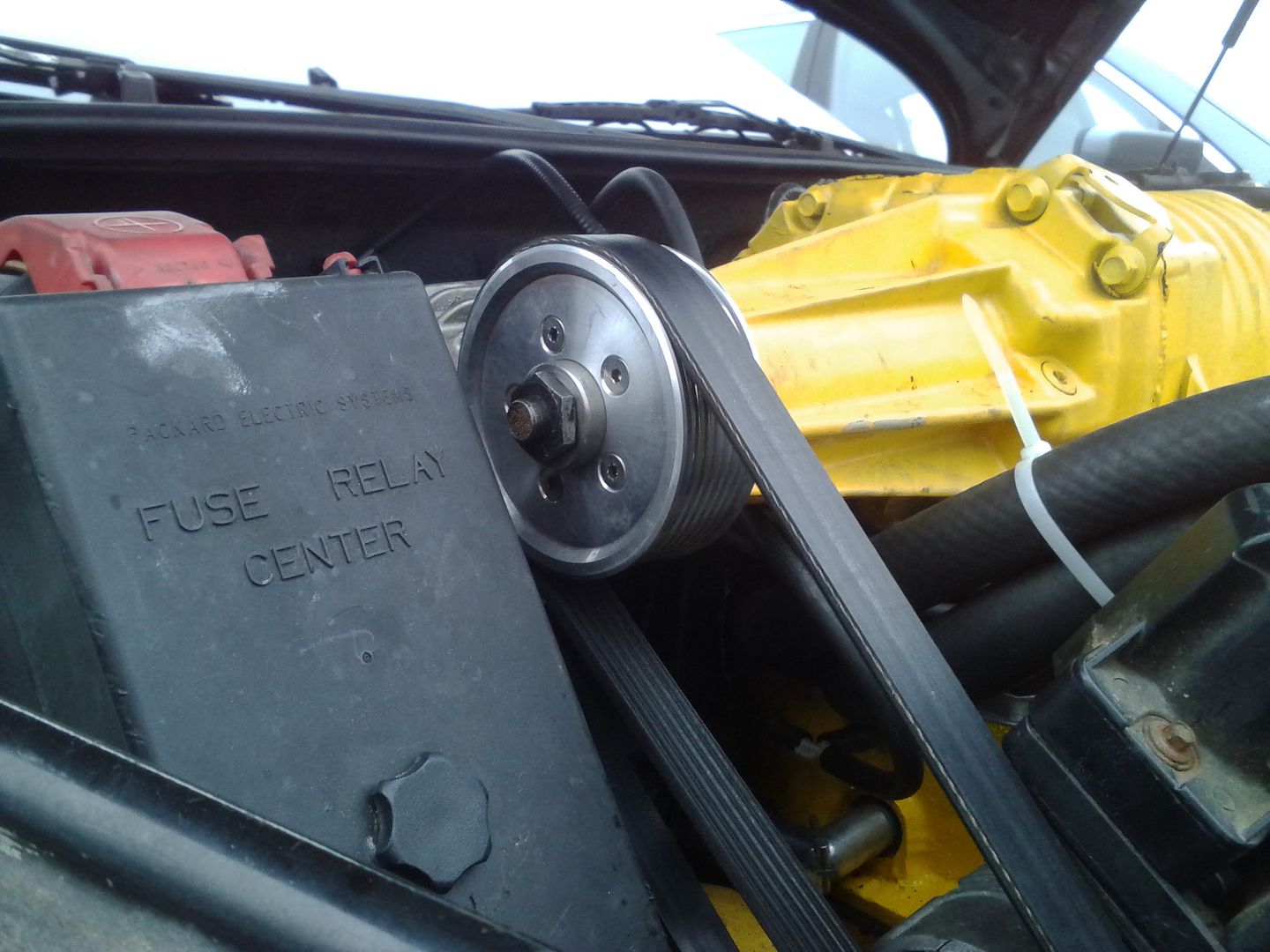

    98gtp was driving yesterday gave it some, gas next thing I know I hear a few clunks n lost boost n most of power...look under hood the supercharger pulley is gone, and only the shaft appears to be fine.. anyone ever had the pulley come off the shaft...it was a rebuilt snout with a3.4 pulley all bought from zzp and they pressed the pulley on the snout last year..

    being ive used a sc pulley puller, id say thats almost impossible. id be calling zzp and asking them wtf?
    pics of the carnage? you find the pulley?

    No couldn't find pulley...I press hub and bearings daily at work press on **** shouldn't just come off a year later

    Mind blowing wtf would cause that it's been a year almost exactly now..it spins freely n when I give the car a lil gas it spins...it was noisy as hell tho..car is nice n quite now. Could I need new rotor needle bearings? When I spin the shaft it feels smooth n play at all..n it had new coupler Could the needle bearings be the reason it was so noisy?? Are they hard to replace

    look under the engine a top the splash shield for the pulley, near the motor mount. if its not down there look again back where it popped off. it maybe cracked. the outer bolt is also gone.

    I just gonna get a modular set up 3.4, but what about this bolt missing send me a pic what it should look like and installed if possible

    yeah, the bolt on the shaft.

    Should be a vented bolt just like the one on the end on this snout

    Mine's always just had a ****in plastic cap in it lol wtf zzp
