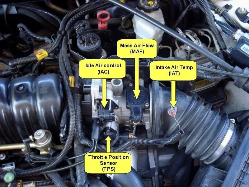

    If it's possibly a MAF sensor I'd start with seeing if it is that as it is easily the easiest thing of that list to check. Remove the engine cover and unplug it and see if the problem persists or changes. If not you can remove it as a possibility.
    There that should help you find it

    Do I just disconnect the MAF remove it? Secondly, after I remove/disconnect it, do I try to drive it or will the change show park/idle?

    the maf test, you unplug it, car off. then start it. if it idles and runs better with the maf unplugged its bad.

    Okay, here's the latest. Took the MAF lead off, no change. Looked in the hose, looks clean and unclogged. Looked at the throttle body, still clean from the last cleaning about three months ago. Checked my wires, and it seems I have a knock in cylinder three now, always had one in four but now its in three. I removed the wire from the coil and the engine quieted down (relatively speaking).
