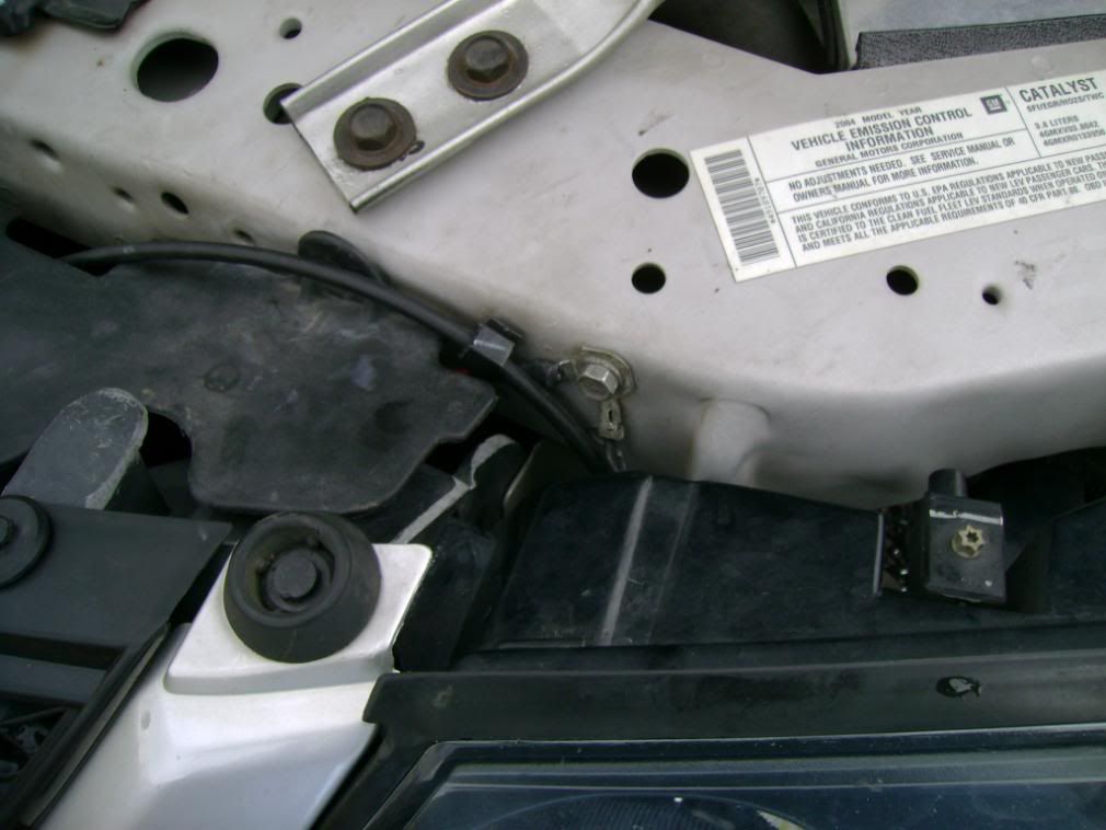

  15. #35 Re: Temperature Problems
    Barksdale AFB, LA
    4,879
    Added wiring is definitely a monkey wrench in troubleshooting electrical problems. Disconnect it.
    Curious, why didn't you use a different ground? Do GPs not have this ground by the driver side diagonal brace?
    http://img.photobucket.com/albums/v3...2/DSC02105.jpg
    That ground is already for the headlight harness, so it's perfect for HIDs or fog lights or something.
    2009 Subaru Impreza WRX STI
  16. #36 Re: Temperature Problems
    TDCRacing
    Guest
    The horn has a ground.
  17. #37 Re: Temperature Problems
    Feb 2008
    West Jordan, UT
    235
    Is that on the drivers side? Or both? The ground wire on the harness was really short so I was limited as to where I could put it. I needed them finished by that night, and was really in a hurry. If I have that, maybe I'll extend it.
