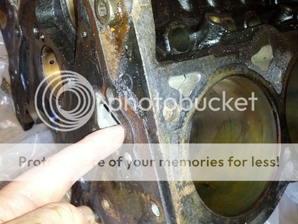

    thanks 4 the suggestions, im gona check it out before work, and see what i can do. and it is one of the middle ones. this one to be exact:

    You can get it out. You can see right down in beside the threaded hole to the bolt laying there if the head is off.

    You could fish it out if you hooked the end of it with something. That's a pretty wide hole at the bottom. Almost reminds you of an iceberg. Doesn't look like much on top but look underneath and it's huge.

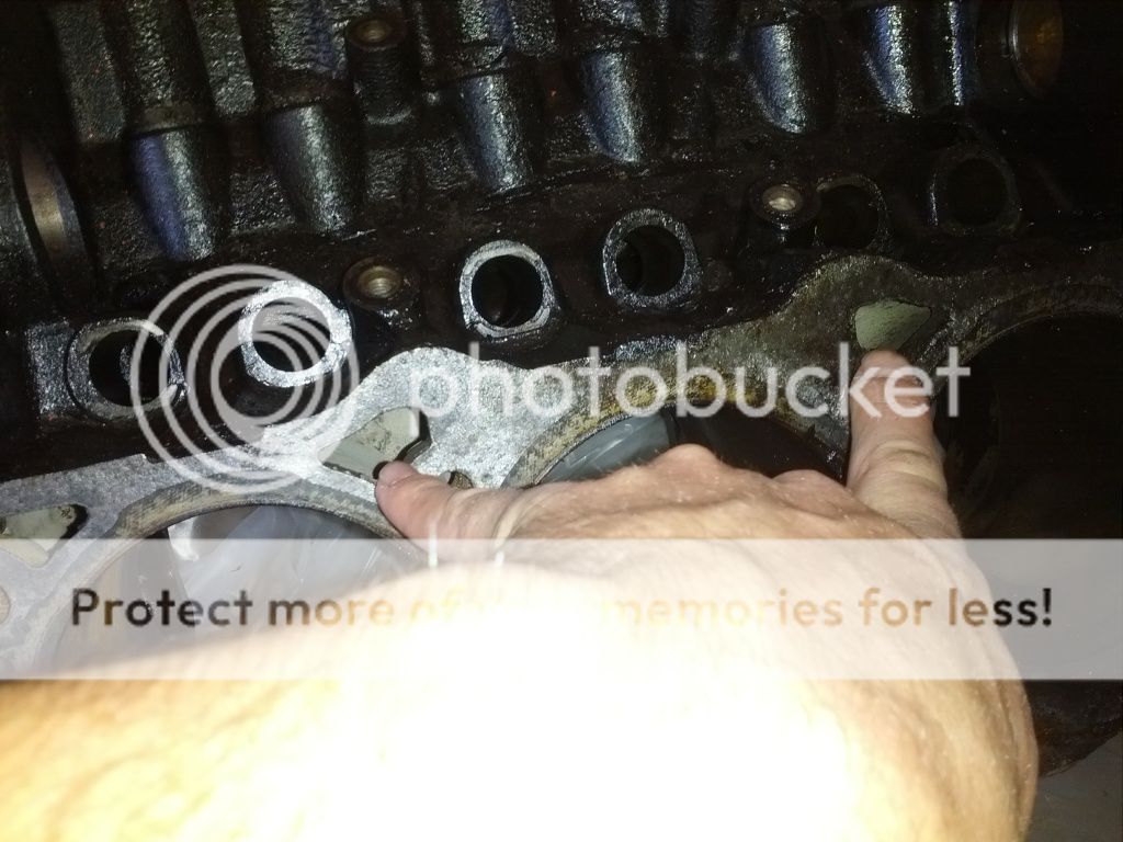

    got the bolt:
    thank you all very much for the assistance. i really appreciate it
